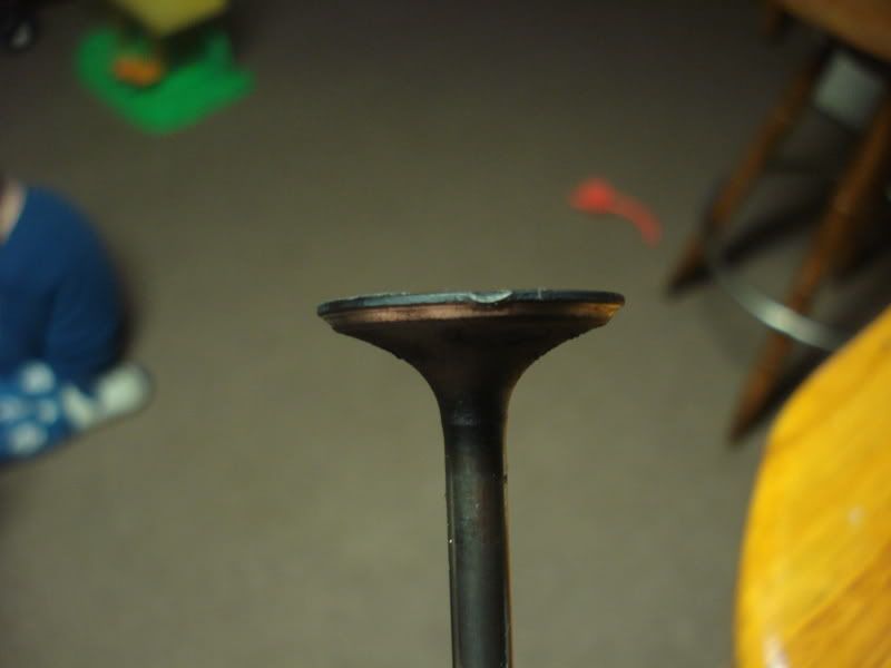

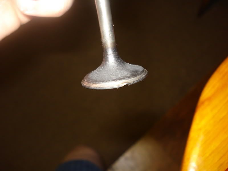

    after seeing these pics, do you guys think i should cut the valve seat and then lap it? and is cutting the valve seat something i could do myself?

    its hard to find a person that can cut the valve seat you have to have certian tools to do it.
    was it running with the valve like that? if not theres probably no damage to the head and just lapping it would work
    DIGGER DOG is offline At The Back Of The Pack Arm chair racerAt the back of the pack
    in the sticks s.w ga
    446
    What was it that made contact with the valves? piston to valve ?valve to piston?
    The tools for cutting valve seats are really $$$$$$ and you have to make 3 cuts
    I would take the head to a machine shop to have the seats cut. if they need it
    can you get us a pic of the head ?
    I just hand lap and either use the suction cup tool or a fuel hose on the tip of valve
    spin it back and forth a few times lift spin seat and spin back and forth a few times
    and I always use fine lapping compund.And after looking at the pics again Id say yea re cut the seats
