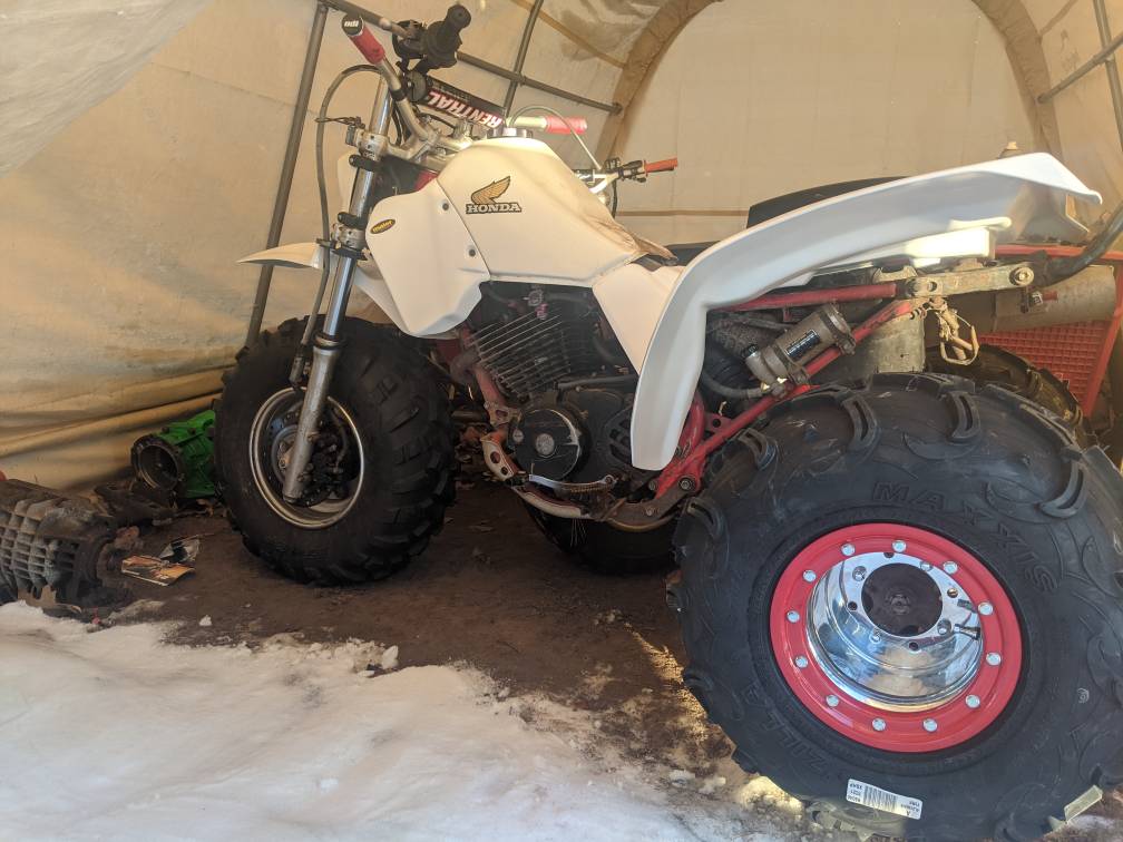

    How it sits as of yesterday morningClick image for larger version.

    Sent from my Pixel 2 XL using Tapatalk
