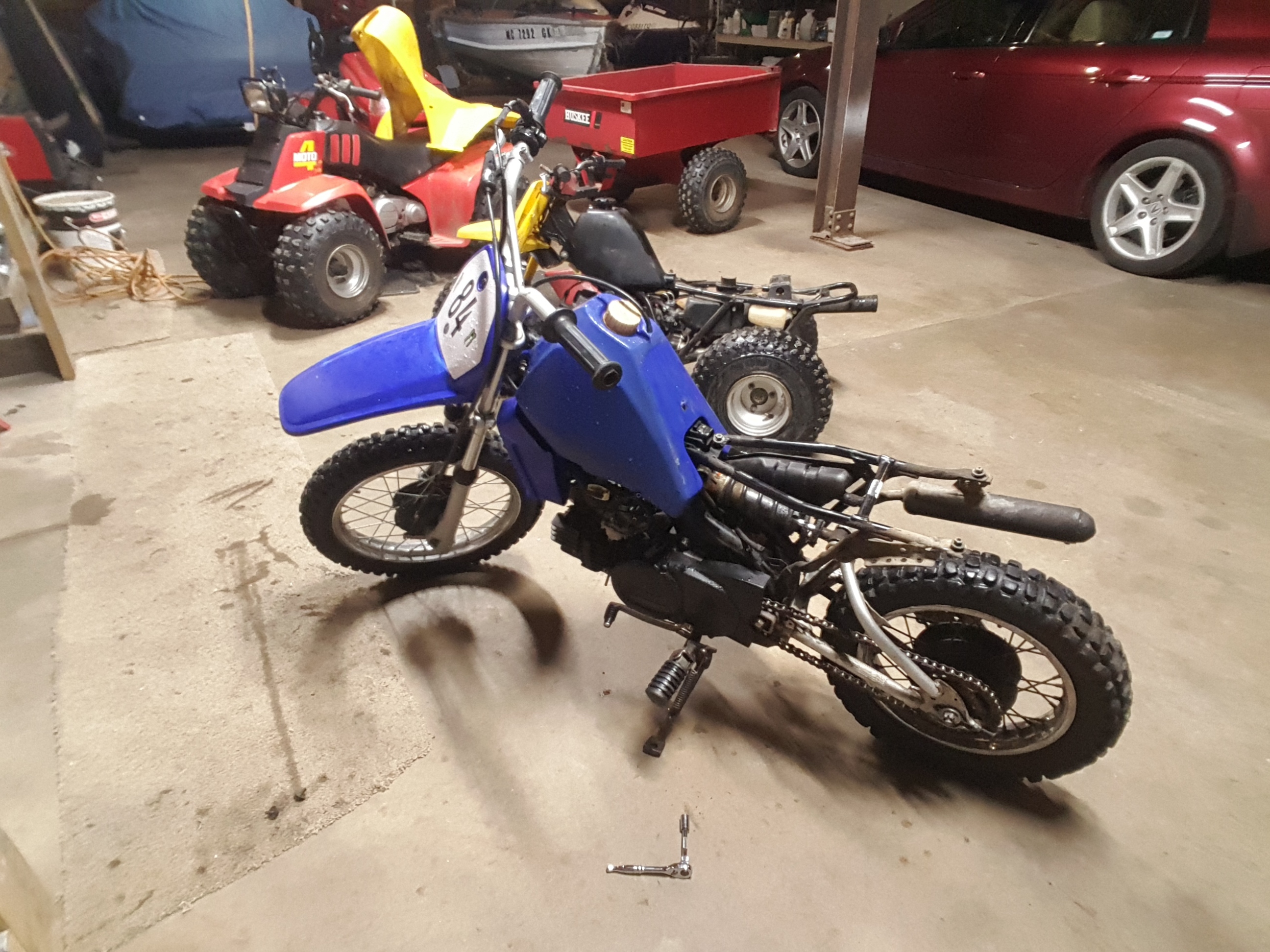

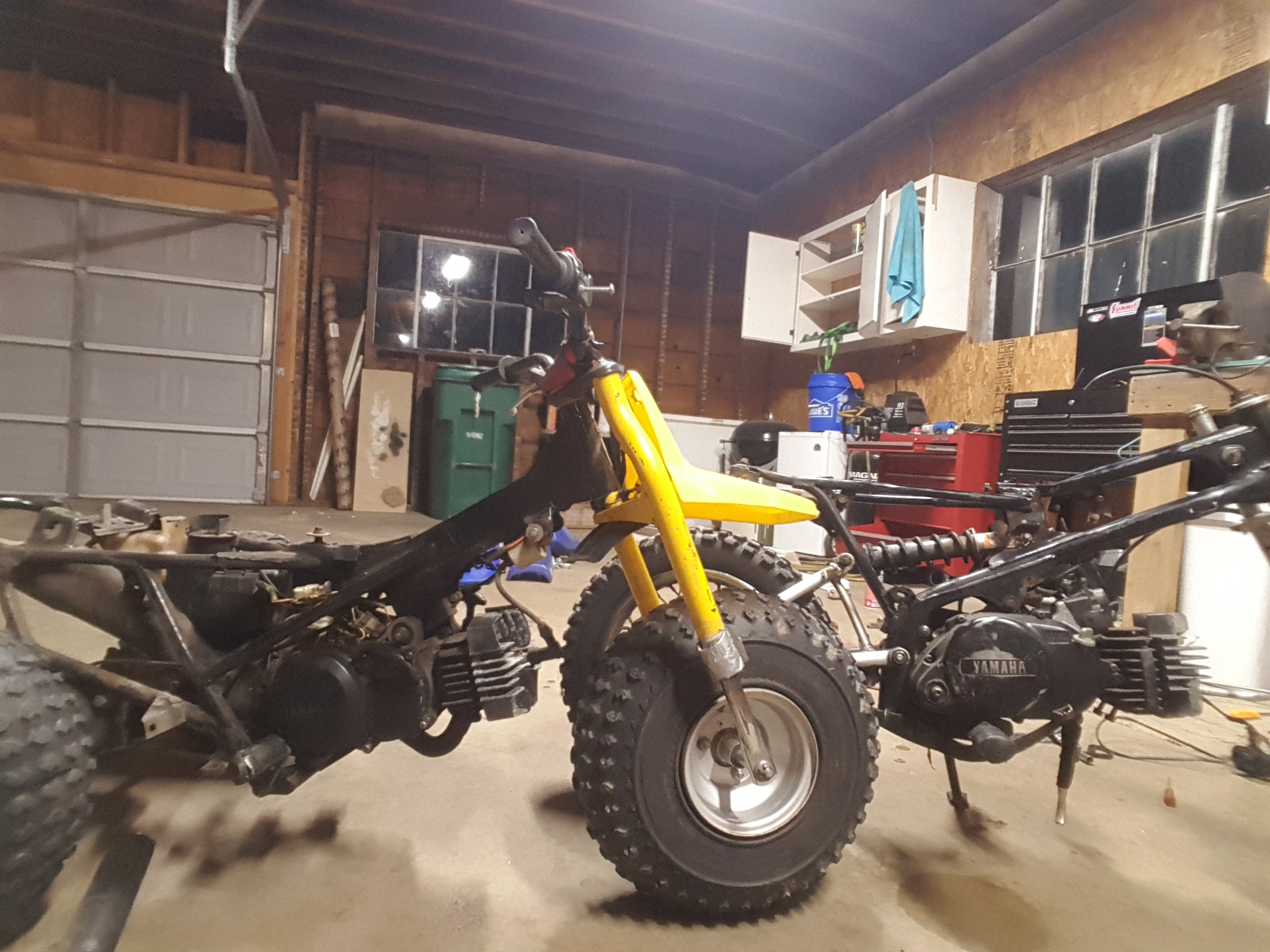

    Alright, so I decided to just give it a go. Picked up a half decent PW80 and tore it all apart. The motors are really close to the same dimensions.
    Not too terrible, the bike is an 01

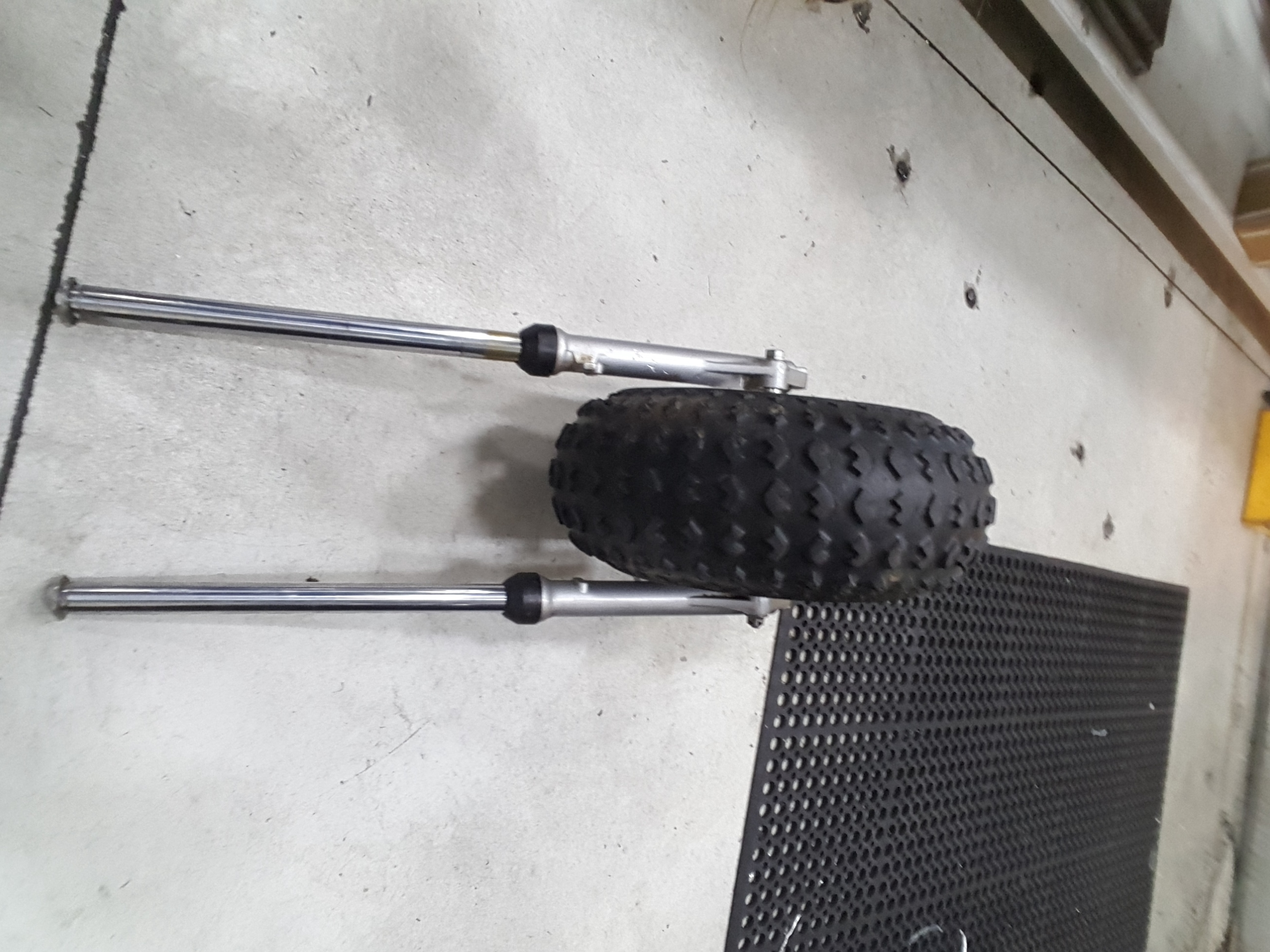

    First thing I got to doing was the fork swap. I had to machine the spacers down and open up the axle hole in the PW forks to 12mm. Also machined the drum brake holder off of the one fork.

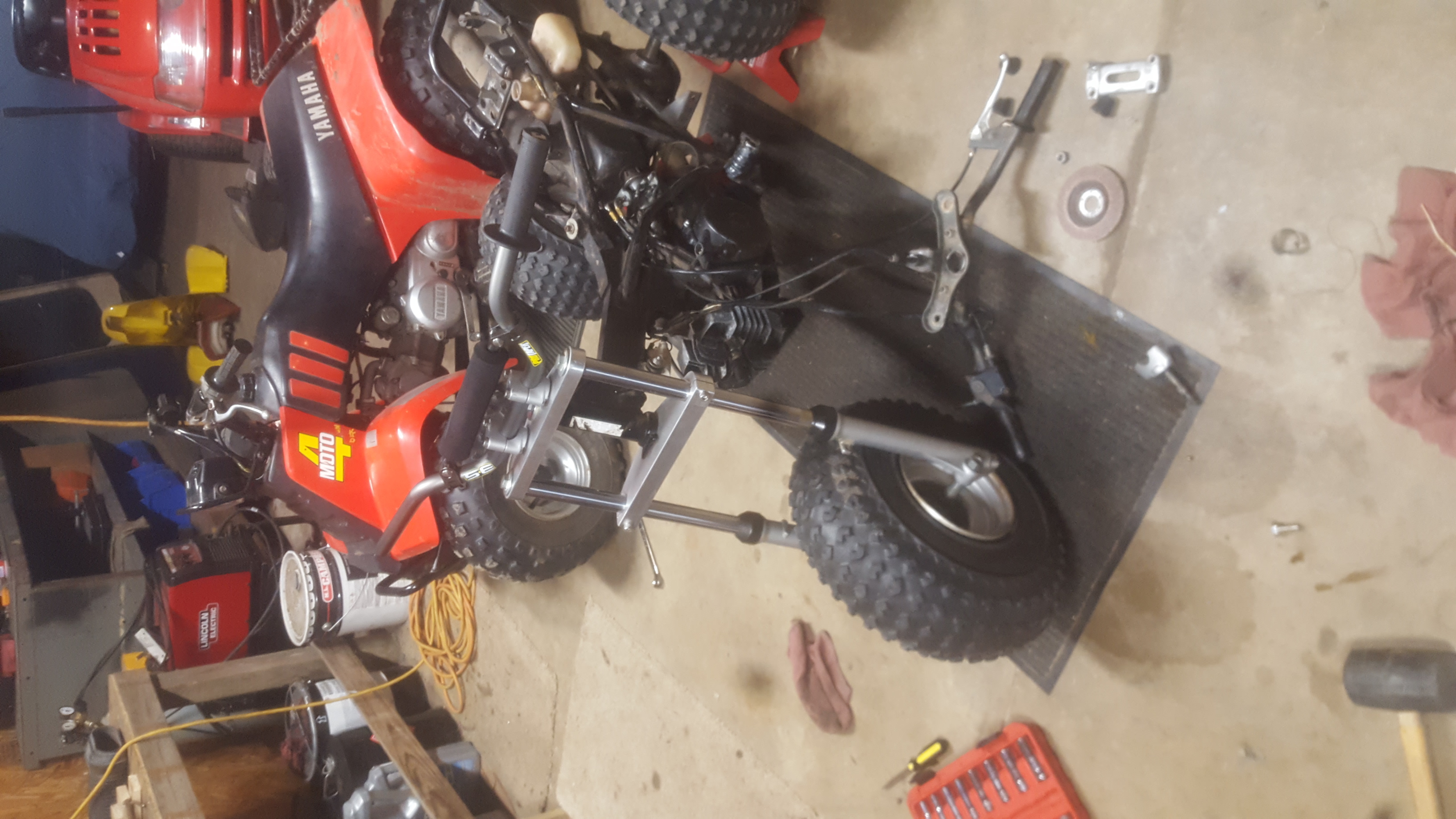

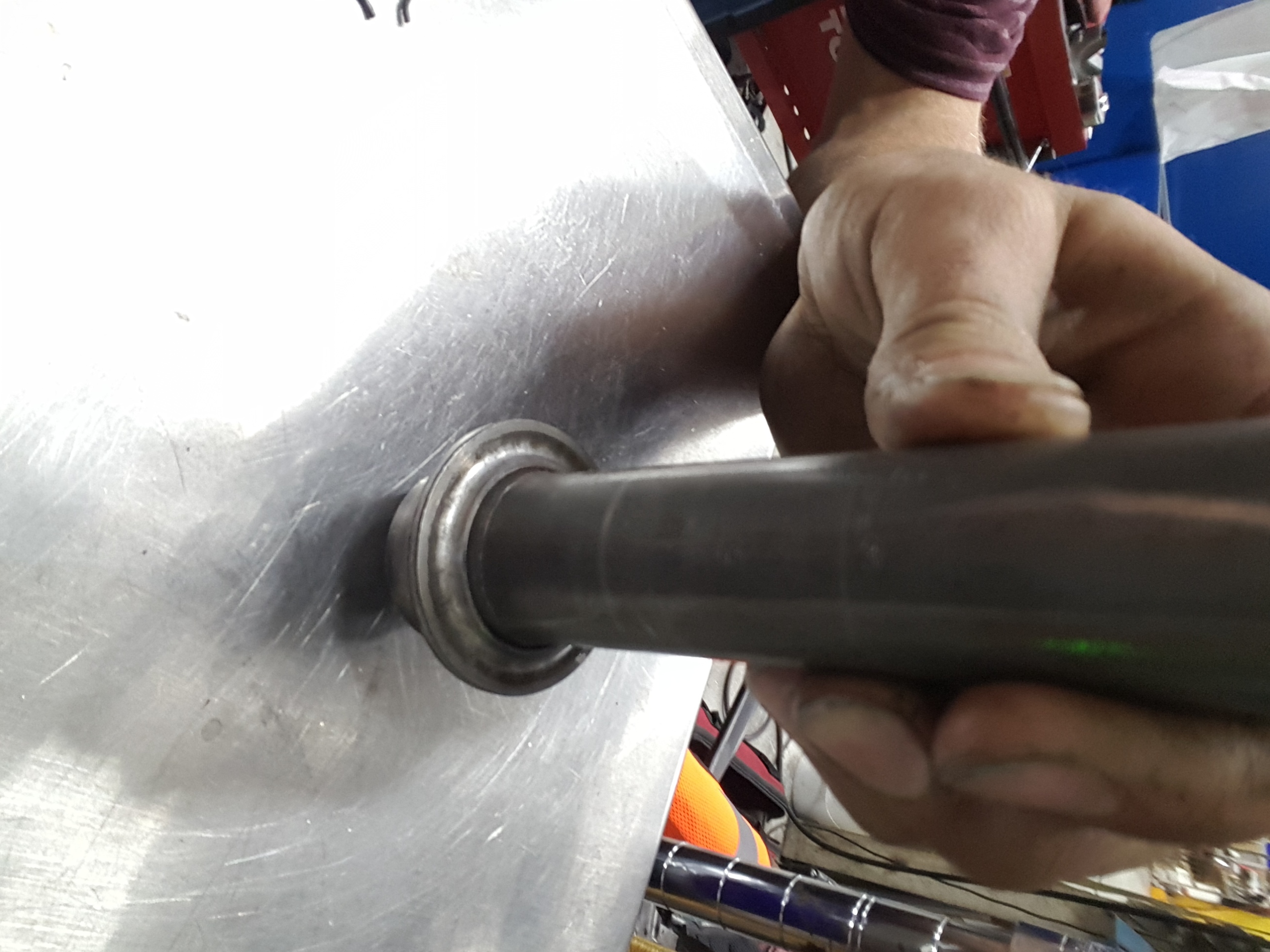

    I had to borrow the lower bearing race from the Tri and slide that onto the neck of the PW (I cut the tube out of the triple and machined both parts to fit just right.) From the base of the bearing race to the top of the threads had to be just over 6 inches

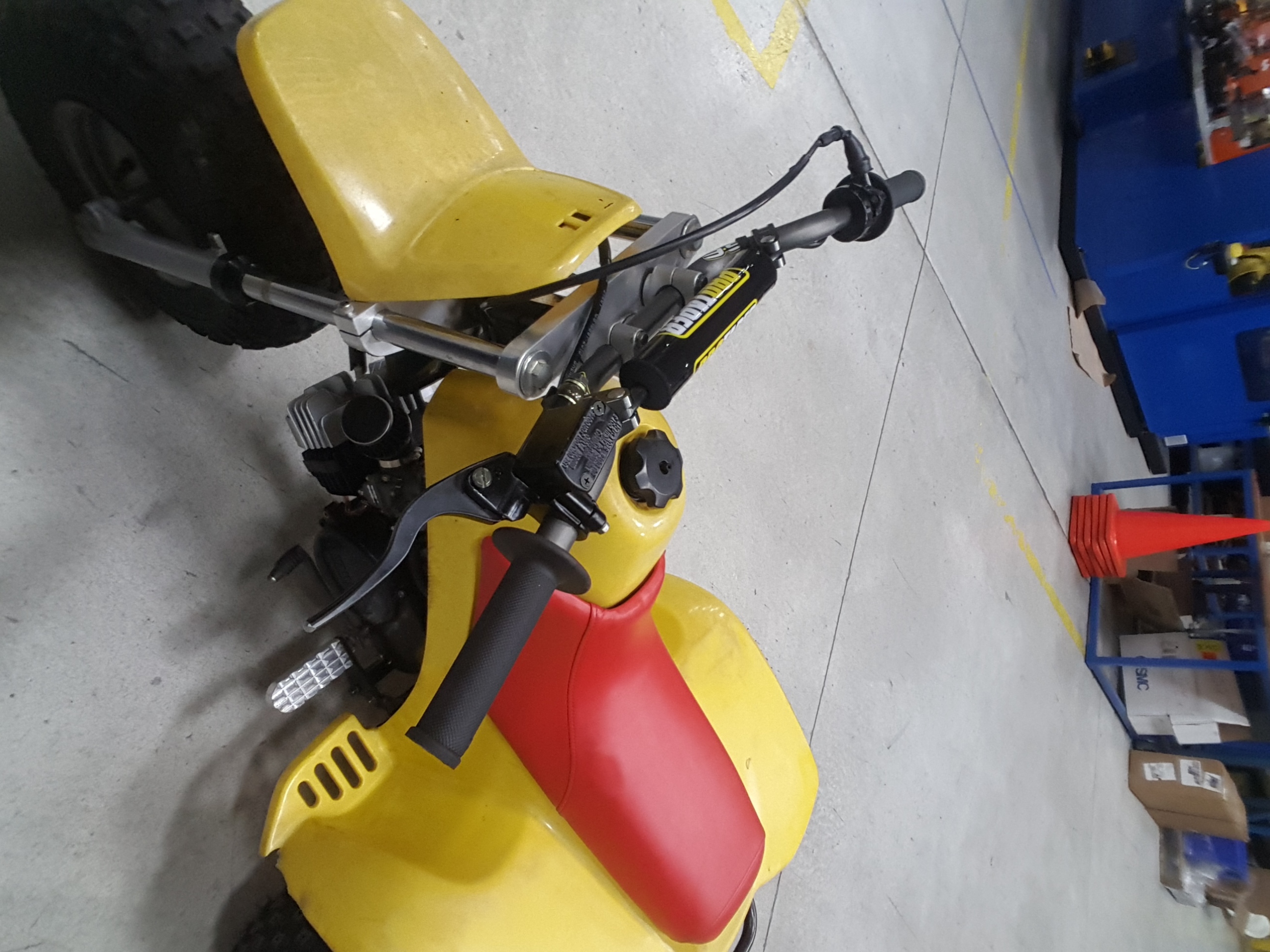

    Here's what I've got tho! I used the old bar clamps from the PW80 and put some ProTaper Schoolboy Pros on.

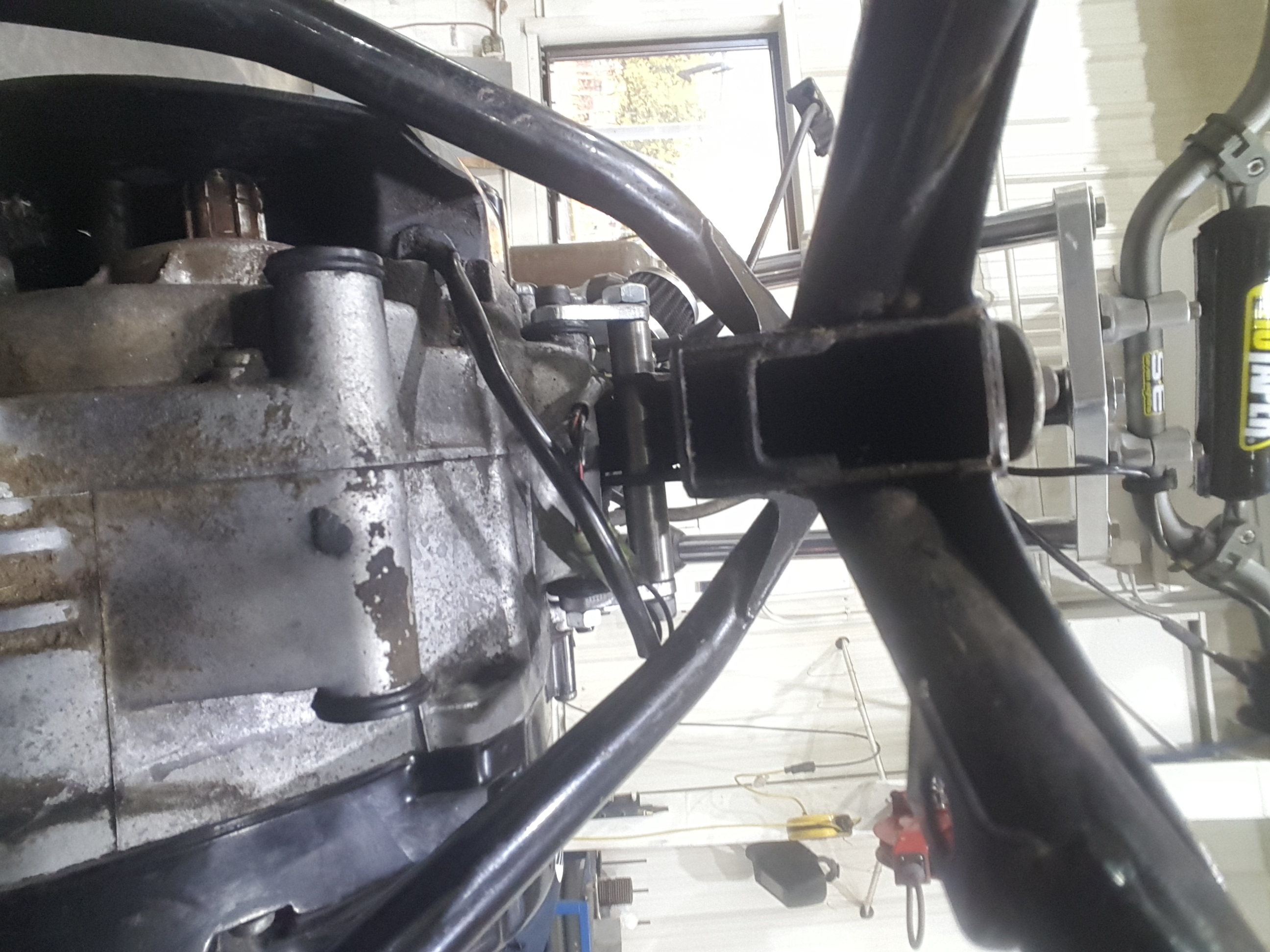

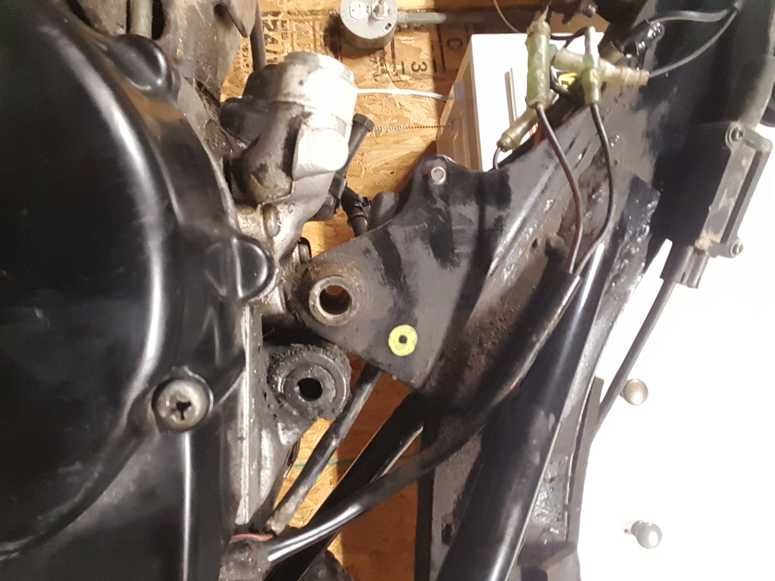

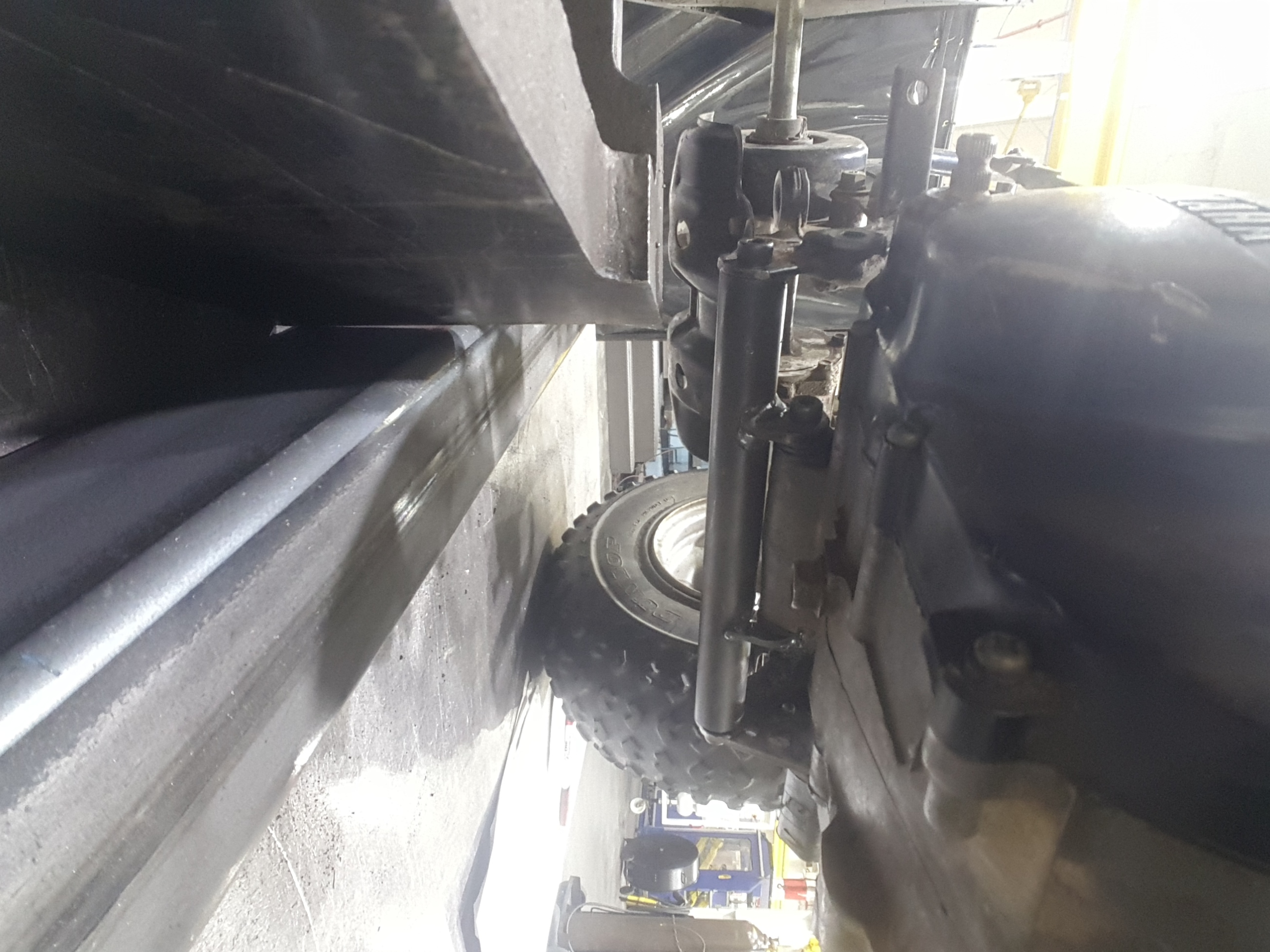

    It runs!!!! It's been a while since I've gotten back, but it's damn near done. First thing to do was make motor mounts, I used the existing holes and made spacers and brackets and drilled one extra hole in the frame.
    Also made a new lower mount with tabs in the correct places. For the motor to fit properly I had to also make spacers to bring the mounts I made away from the frame.

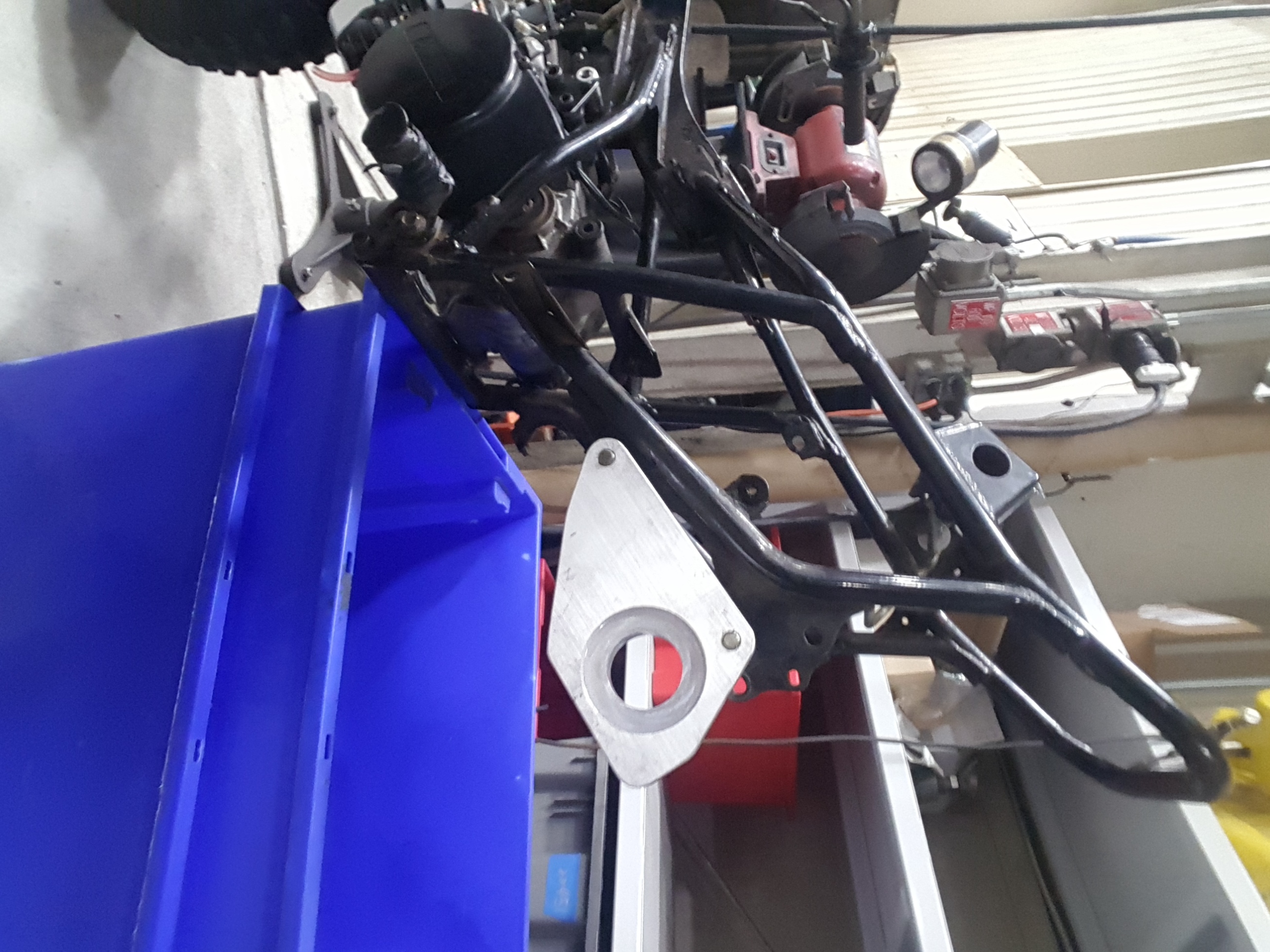

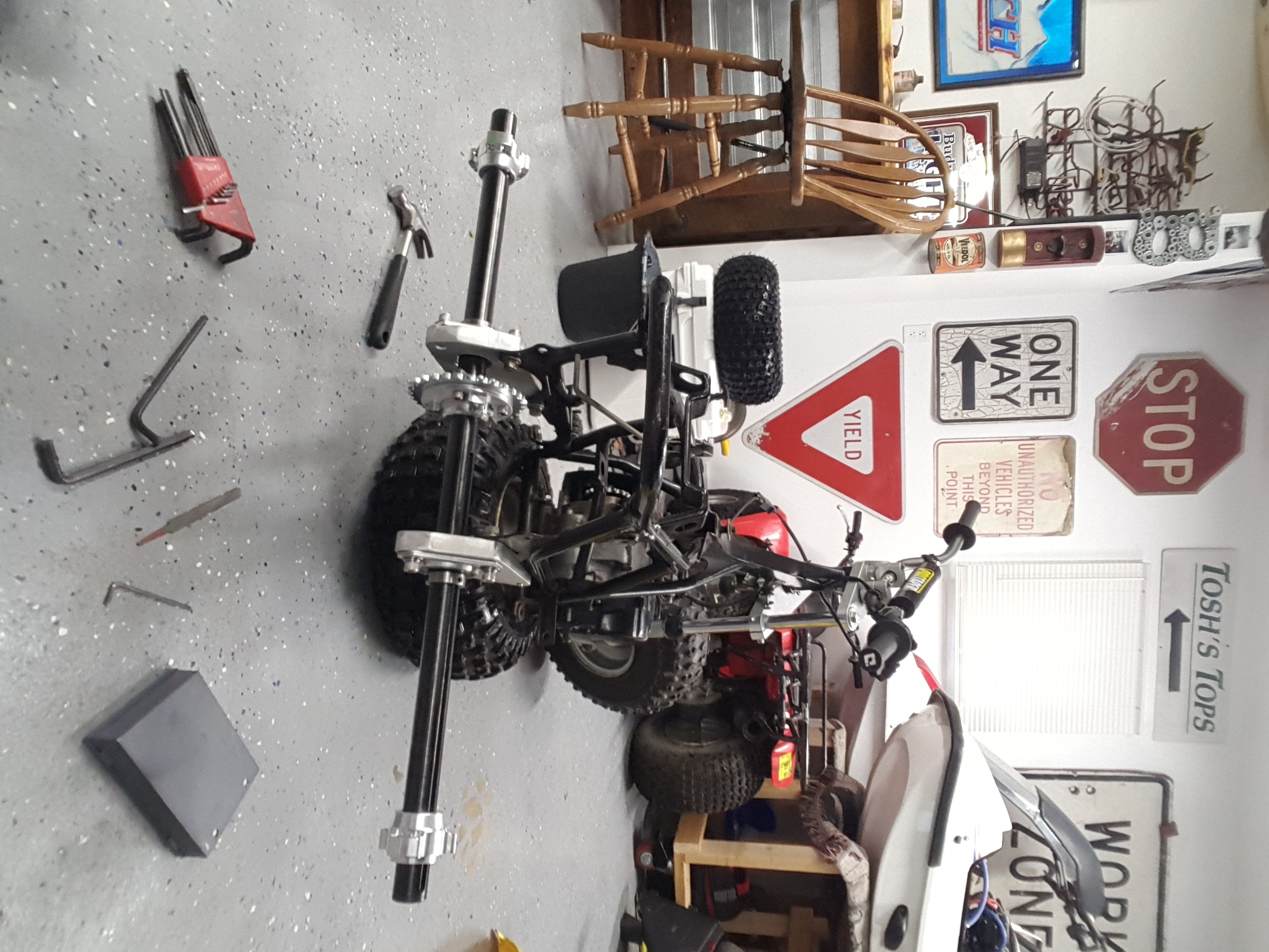

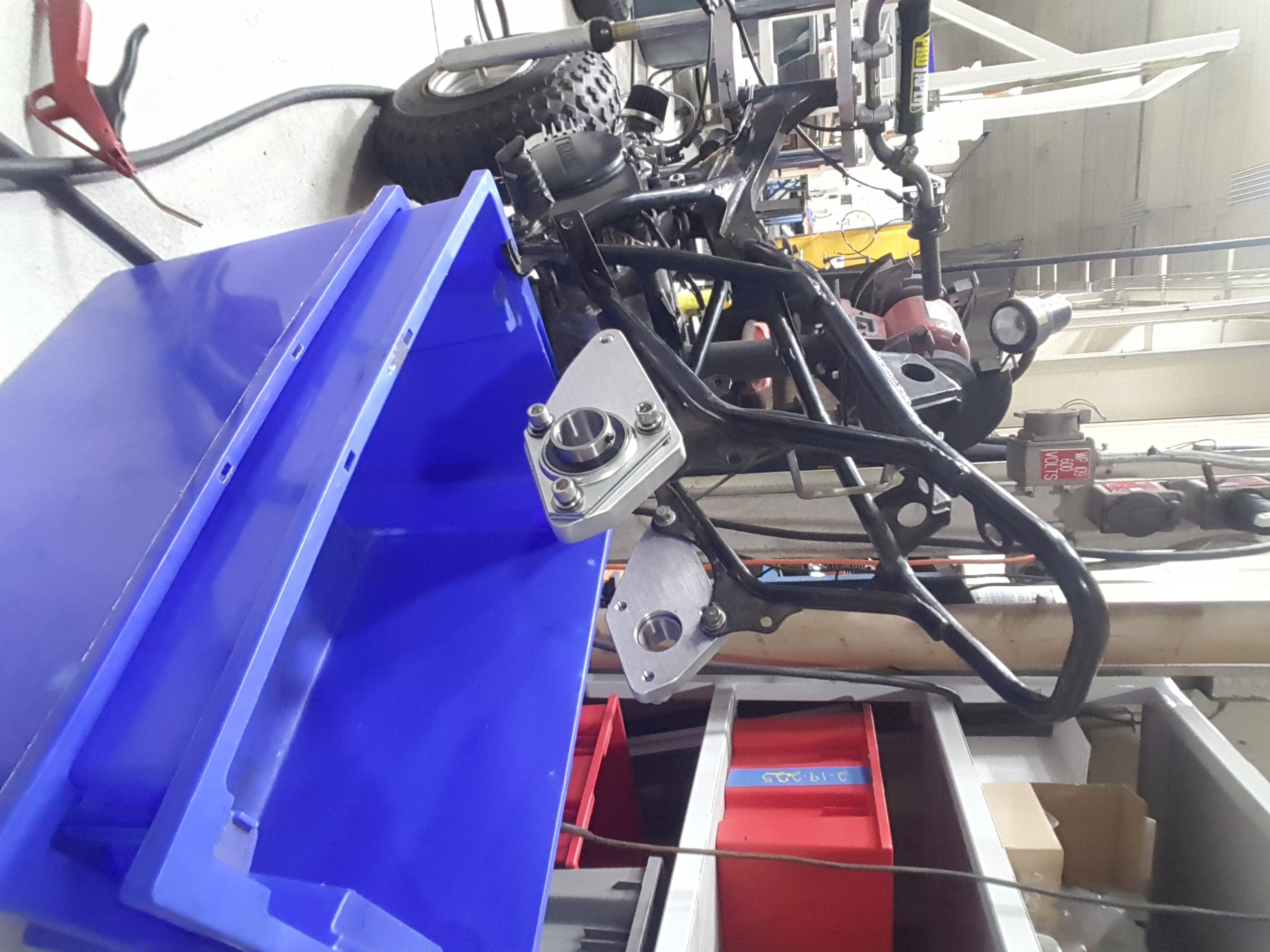

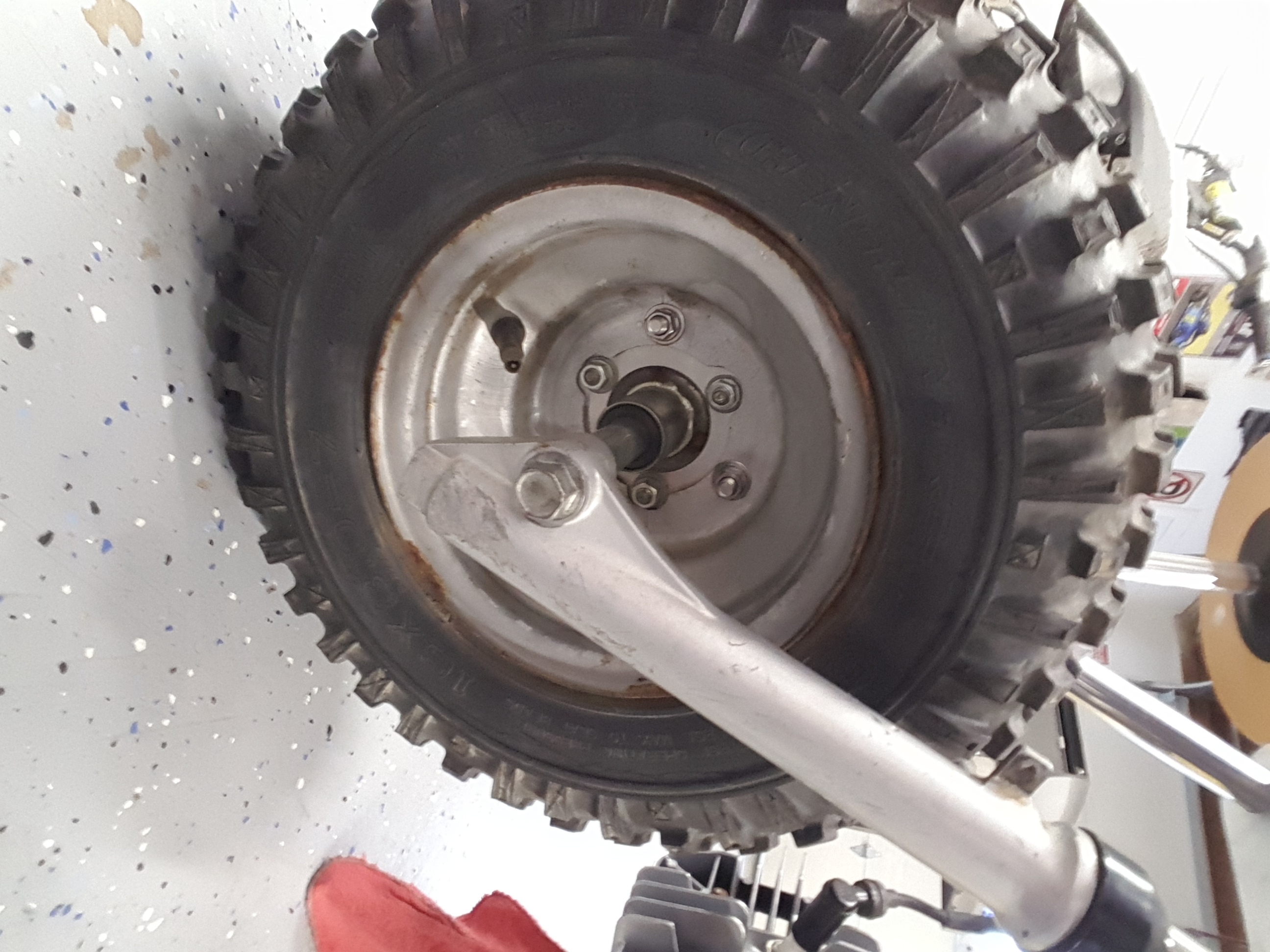

    After that I got to work on the rear end. I designed brackets and machined them out so that my bearings would be partially recessed. The axle is also 2in farther back and about 1/2 lower than the original position.
    I used the existing holes on the frame, measuring with the old rear end.

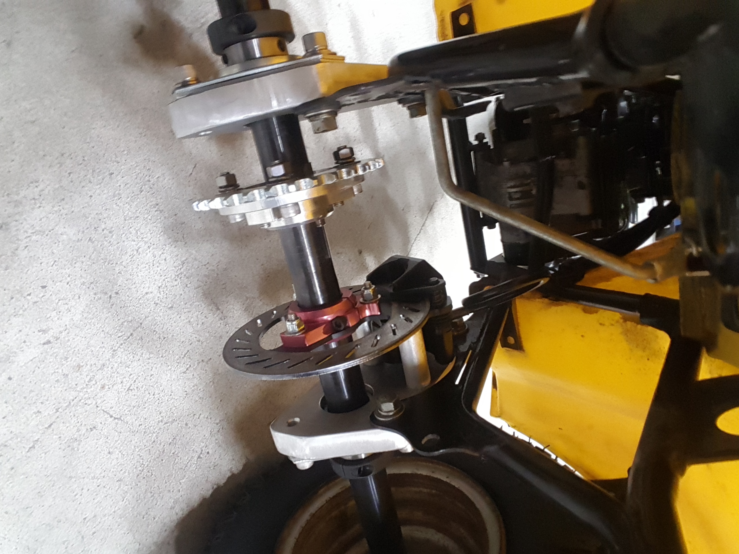

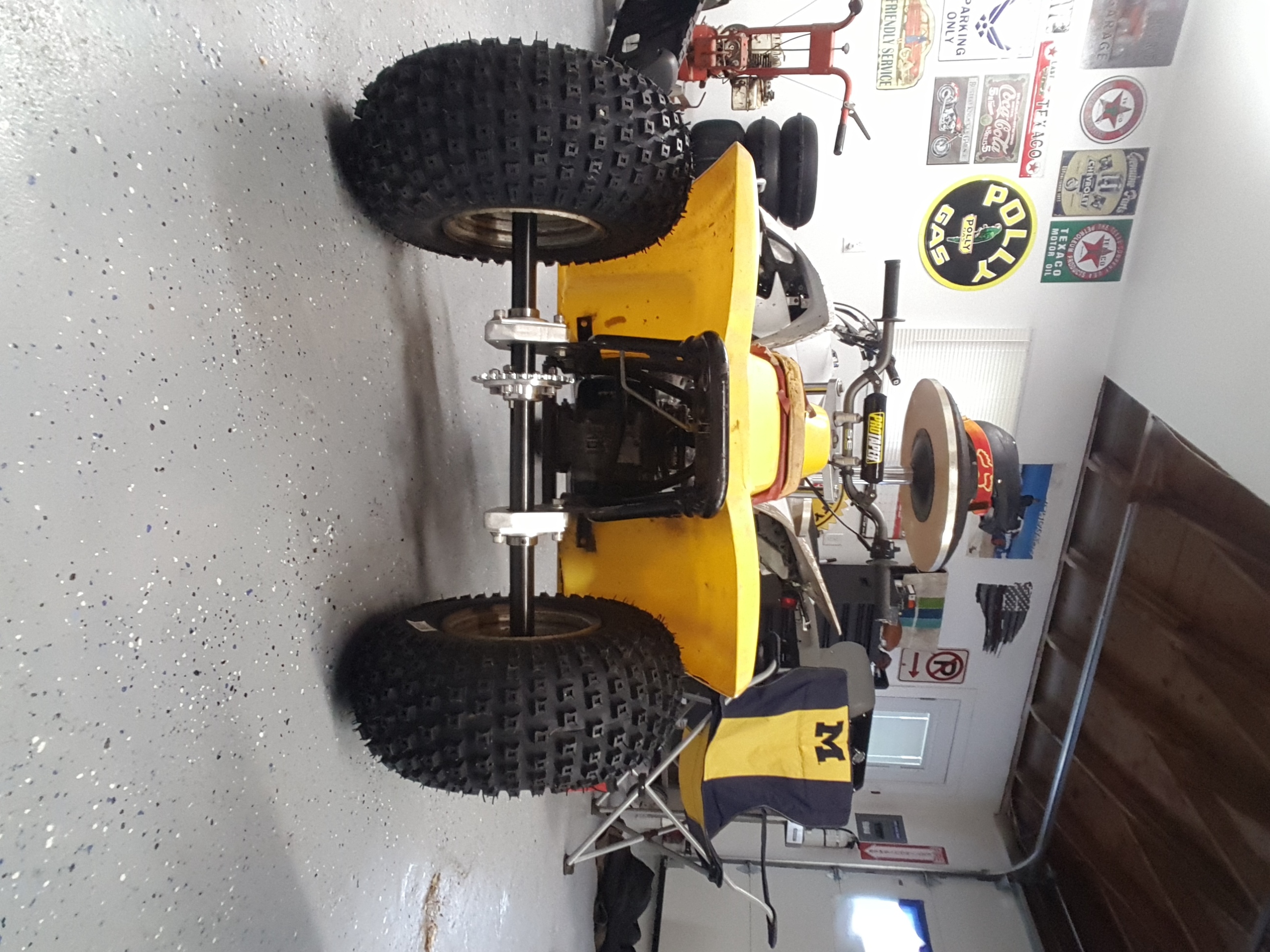

    I had to make adapter plates for almost everything, I wanted to put 7in rims from a YFM80 on it so i had to go from a 3 bolt go cart hub the the 4 bolt wheel pattern. Also had to make a plate for the rear sprocket to mount to.
    The axle was about 6 inches too long and needed to be trimmed up. But so far so good!

    I made another adapter plate for the front end and machined the existing axle spacers to make the offset correct. This was also a Yfm 80 wheel.

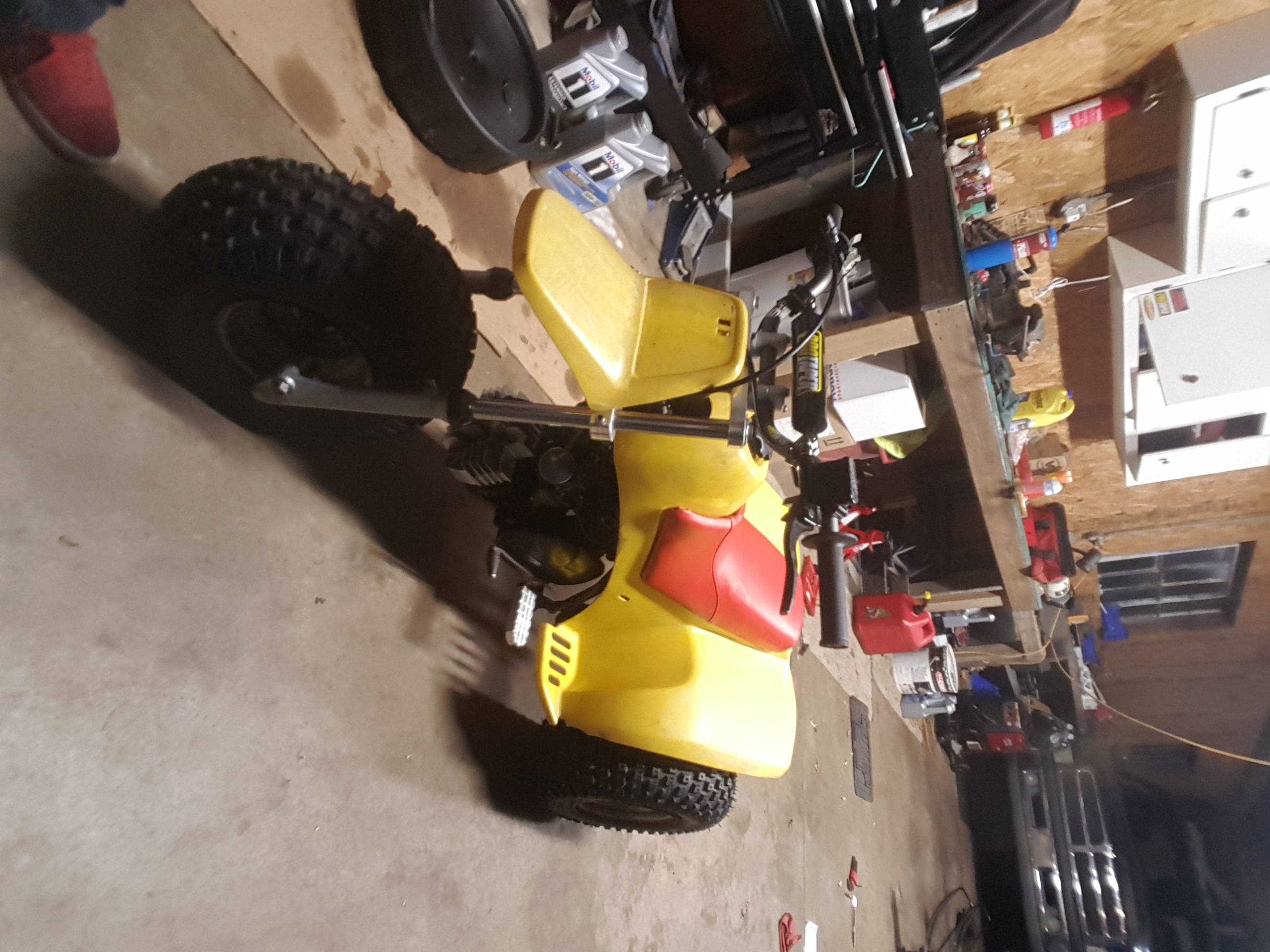

    Much better with the same size tires all around

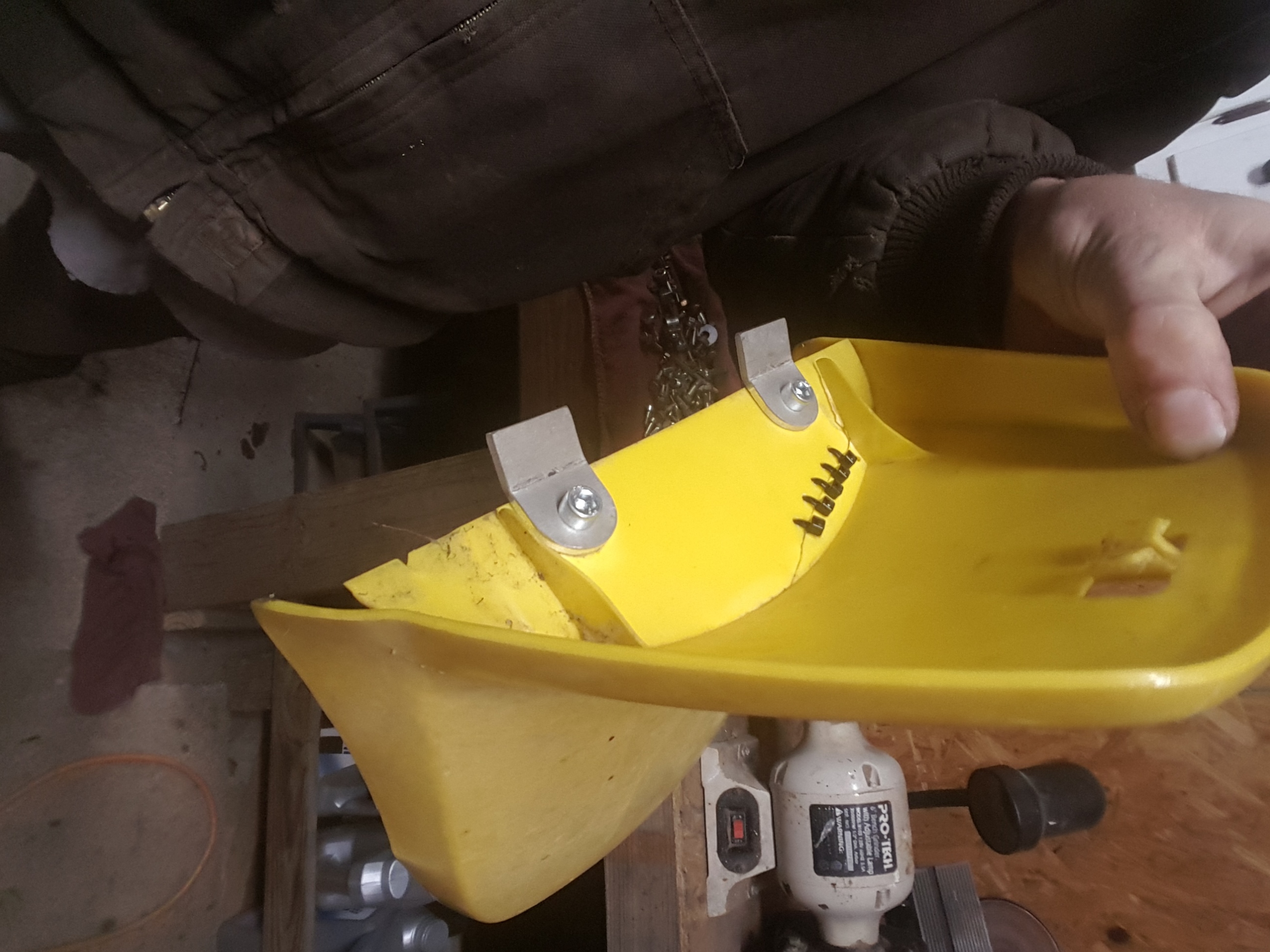

    After that I decided it was time for the front fender
    I made some little brackets out of 1/8in aluminum and drilled and tapped my triple. Also mounted the little black splash guard. While I had the triple apart, I also filled the forks with new oil (6.5in from top with spring out and compressed) and added a 1.25in aluminum spacer above the spring for better preload.

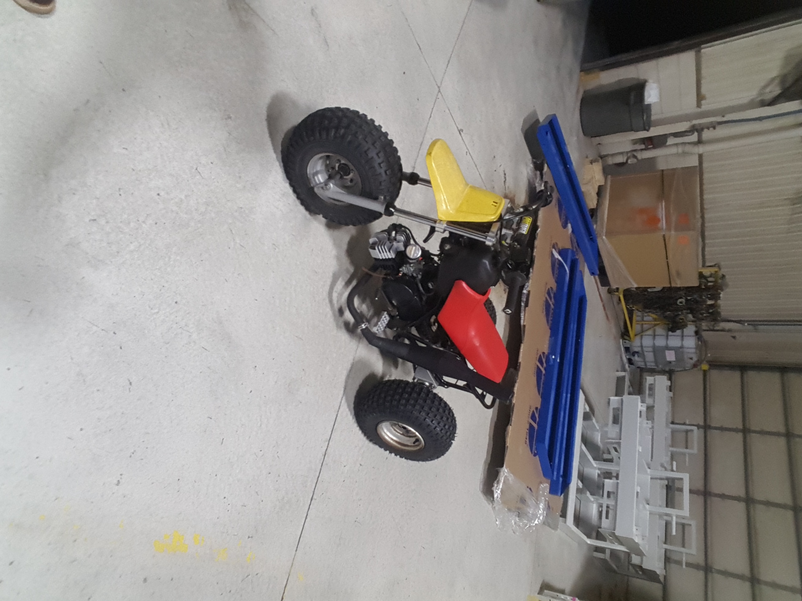

    Next was routing the chain. There was a piece of tubing that held the oil reservoir that was just a tad too low. I decided to cut it out and weld my own piece in, just a little higher. Even if I were ever to put the YT60 back to its original glory, I would just premix. So no need for it.
    Now that I had a chain and brakes it was time for a little test and tune, Jerry rigged the exhaust up (kindof looks like a drag pipe set up. )

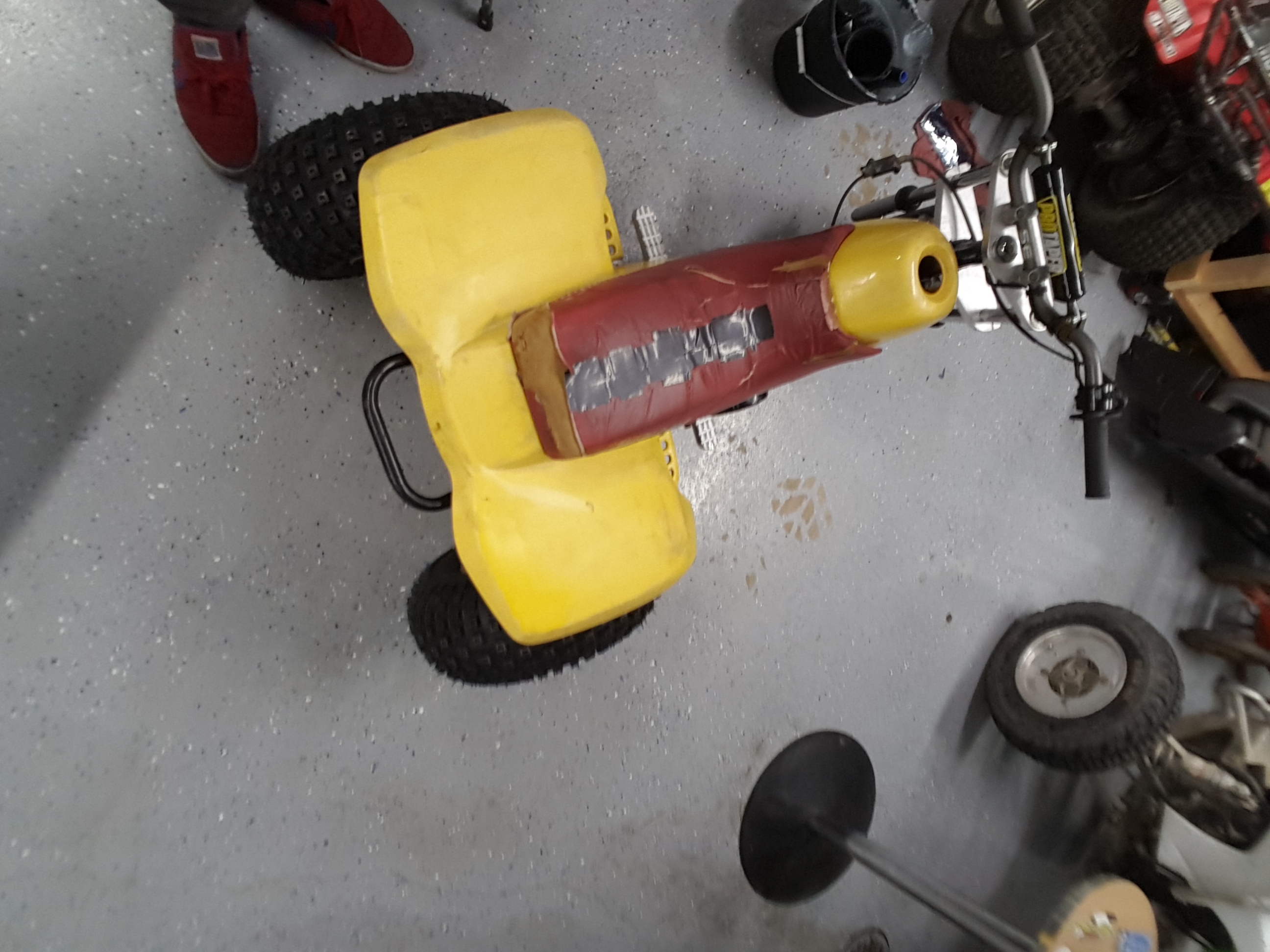

    Now that I know it runs well, I'm going to cut and weld the exhaust so it exits in the right place, oh yeah, and I'm sure you noticed, but at some point I threw a new seat cover on it. GPS top speed was 39.8mph. And I know I can squeeze more out of the top end. I'll be back with another update when it's all finalized and finished. Ah yes, and thanks ironchop, this ones been a blast.
