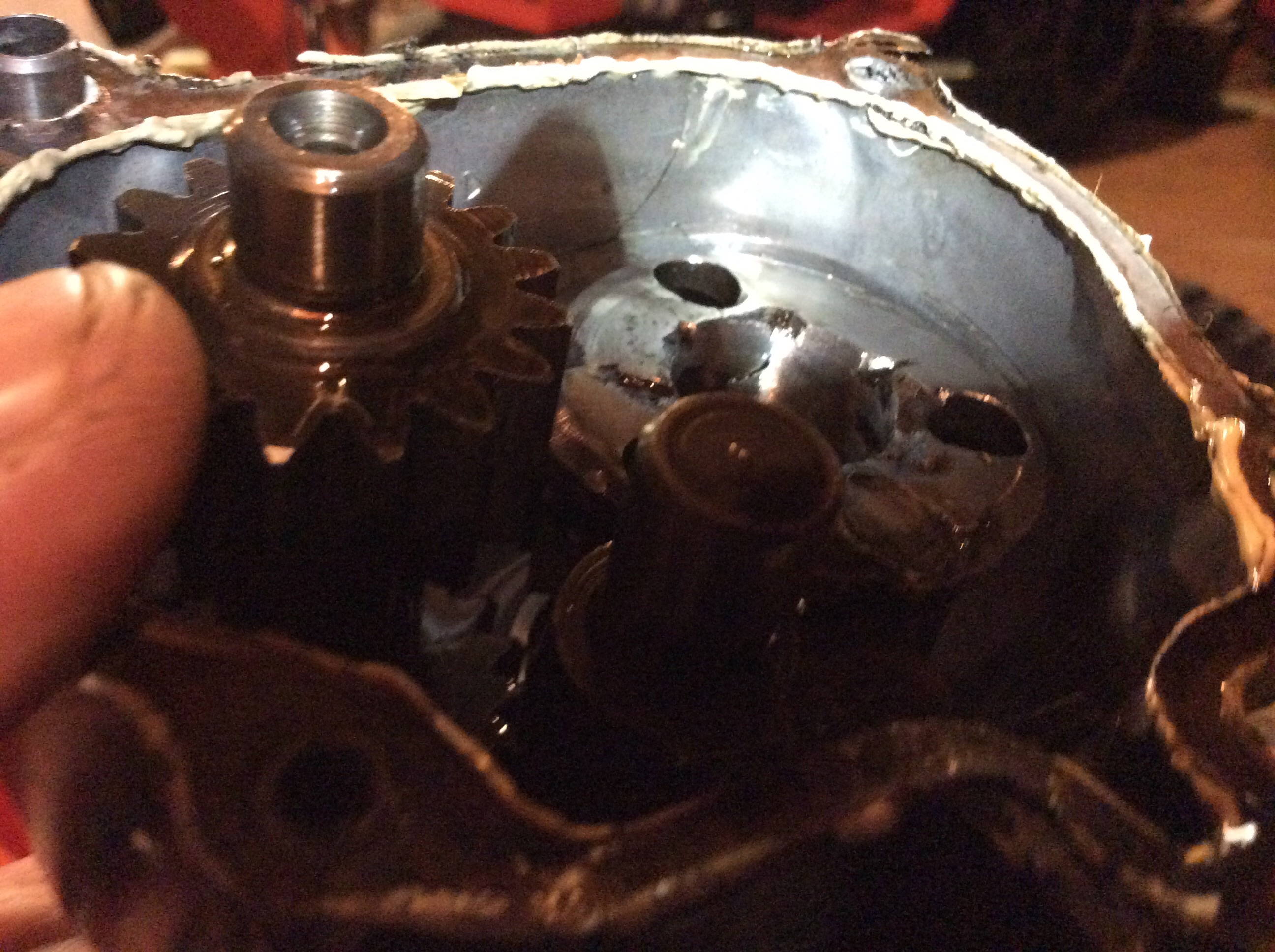

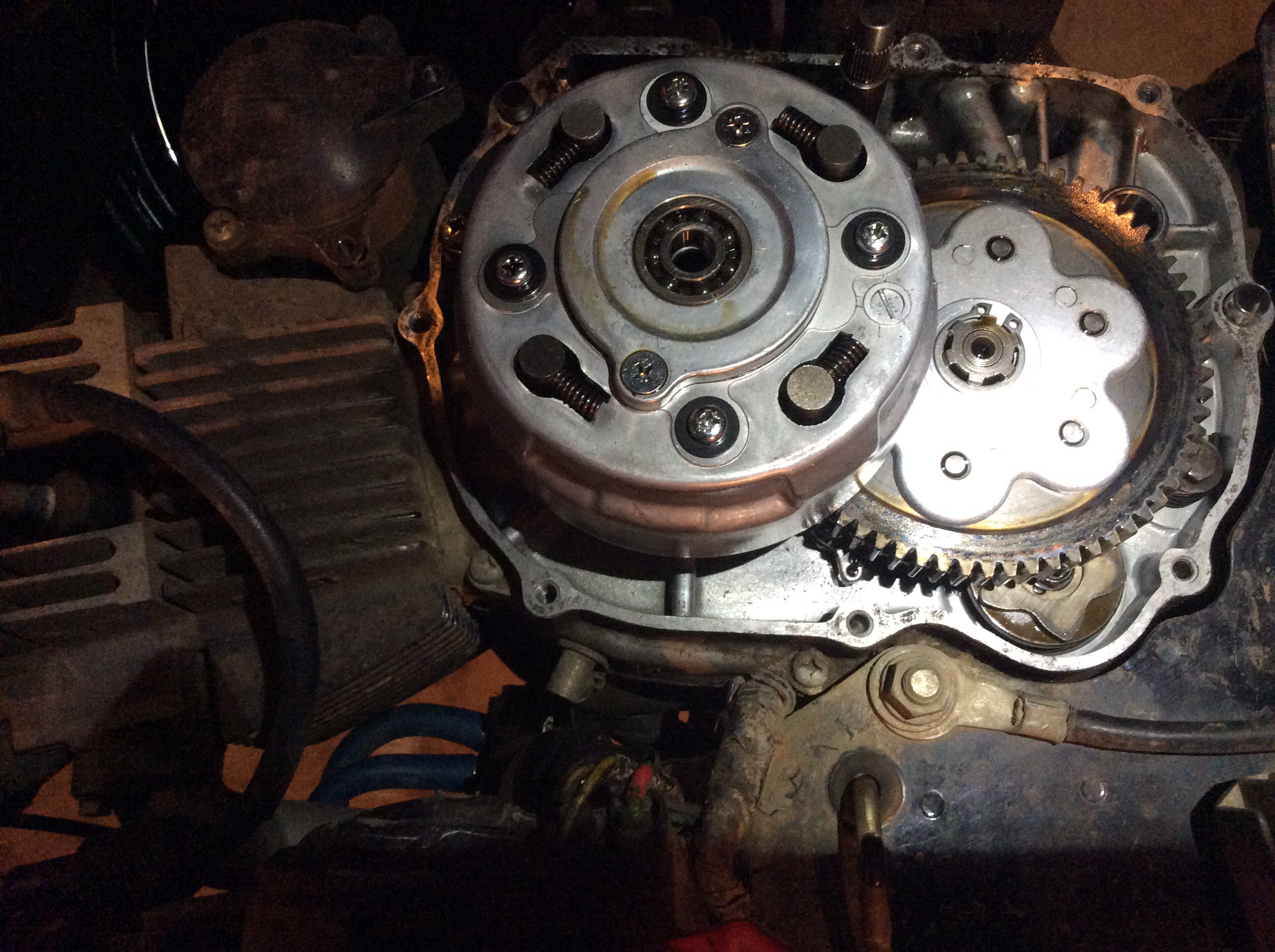

    I adjusted the clutch and no affect. Pulled off the right side case cover and no loose bolts or anything. Put the hi low sub trans in neutral and noise still there then notice the case on the sub tranny had silicone on it. Pulled the sub trans off and could see it had been broken and the case was welded and a gear was broken but repaired as well. Started the bike with sub trans off and noise was still present.

    I did pull the clutch cover and alls well. The Posi-Trans is a different story, the case was broken and the gear inside was damaged. Some pictures to show the situation.

    i cant see exactly what is damaged but the obvious plan would be to fix it and then see if the noise is gone.
