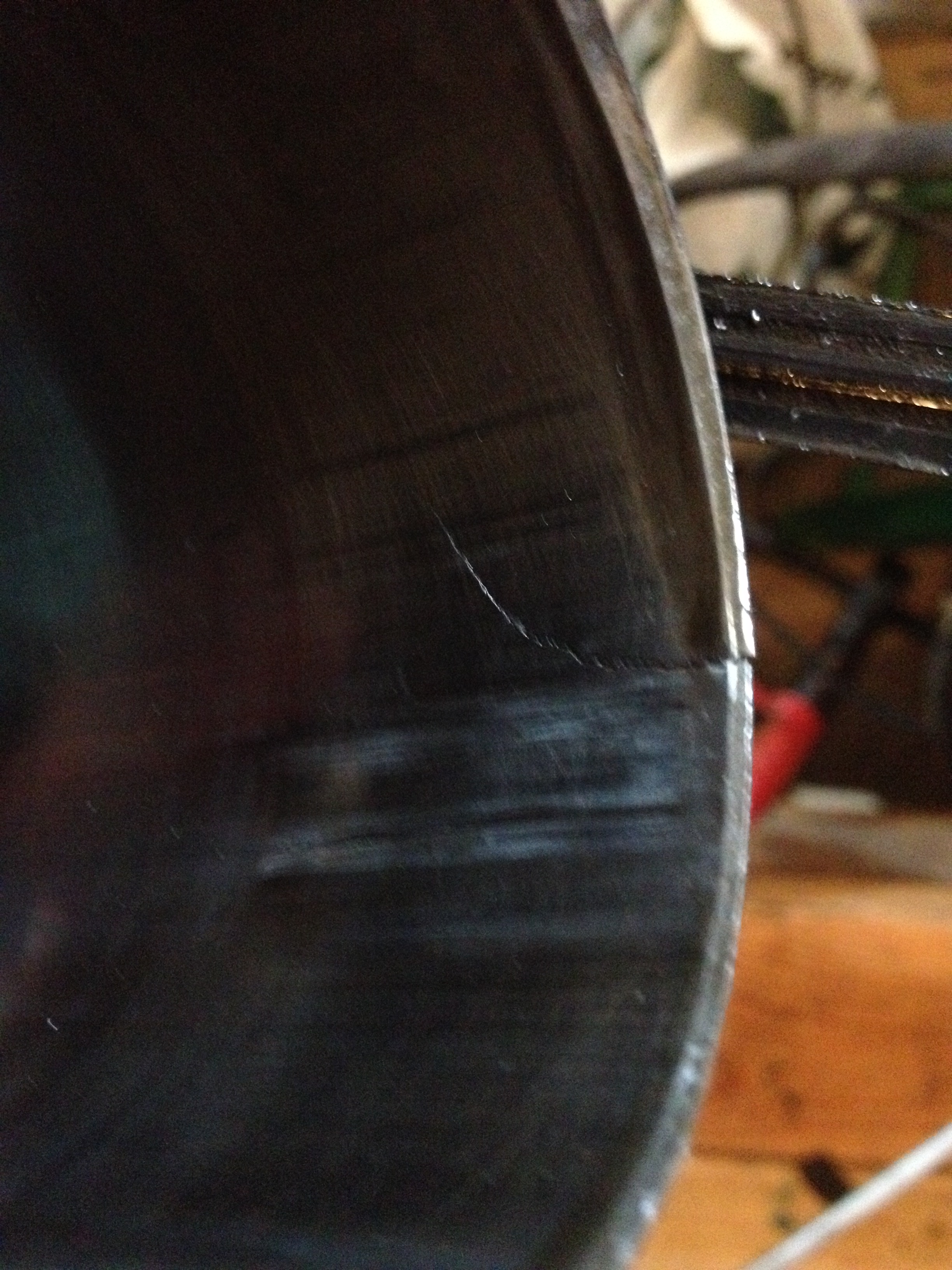

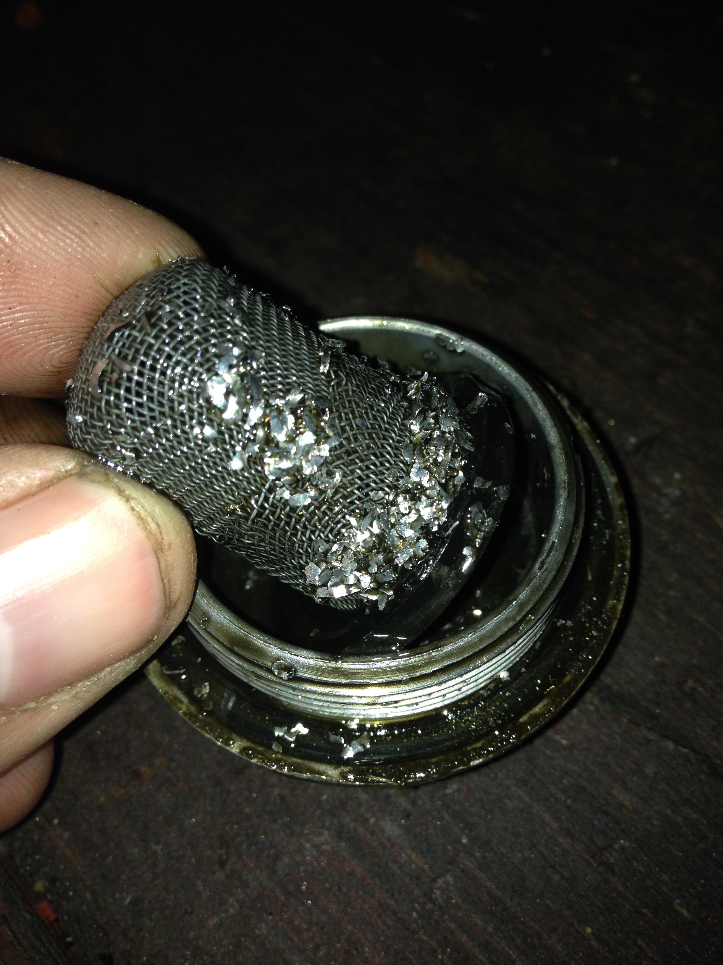

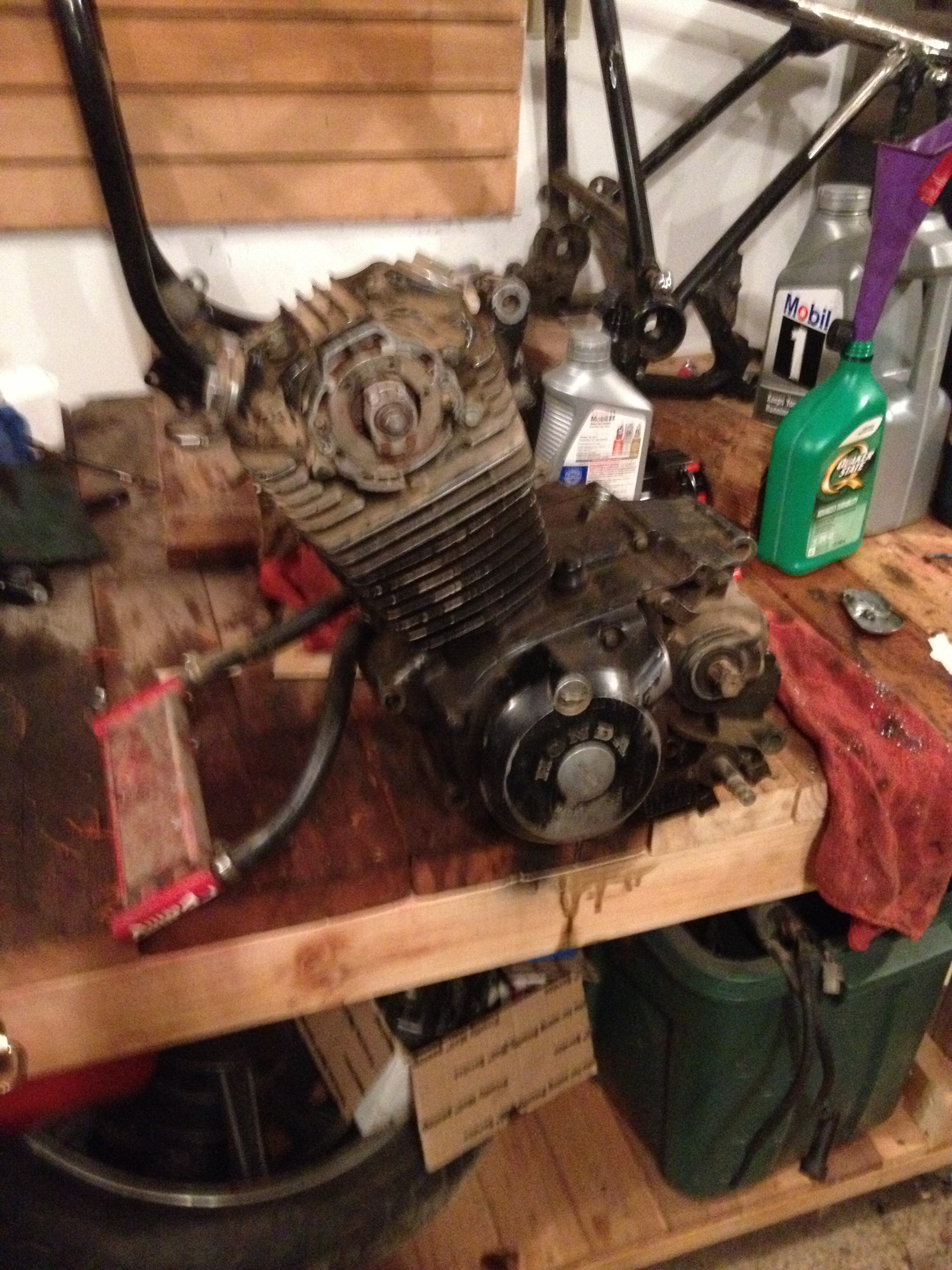

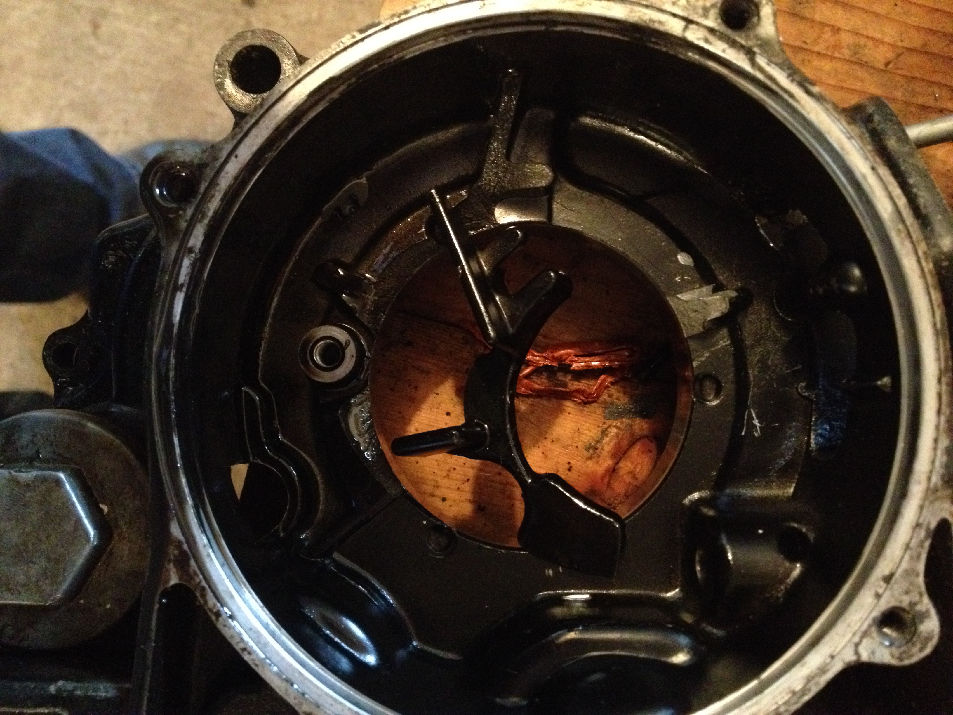

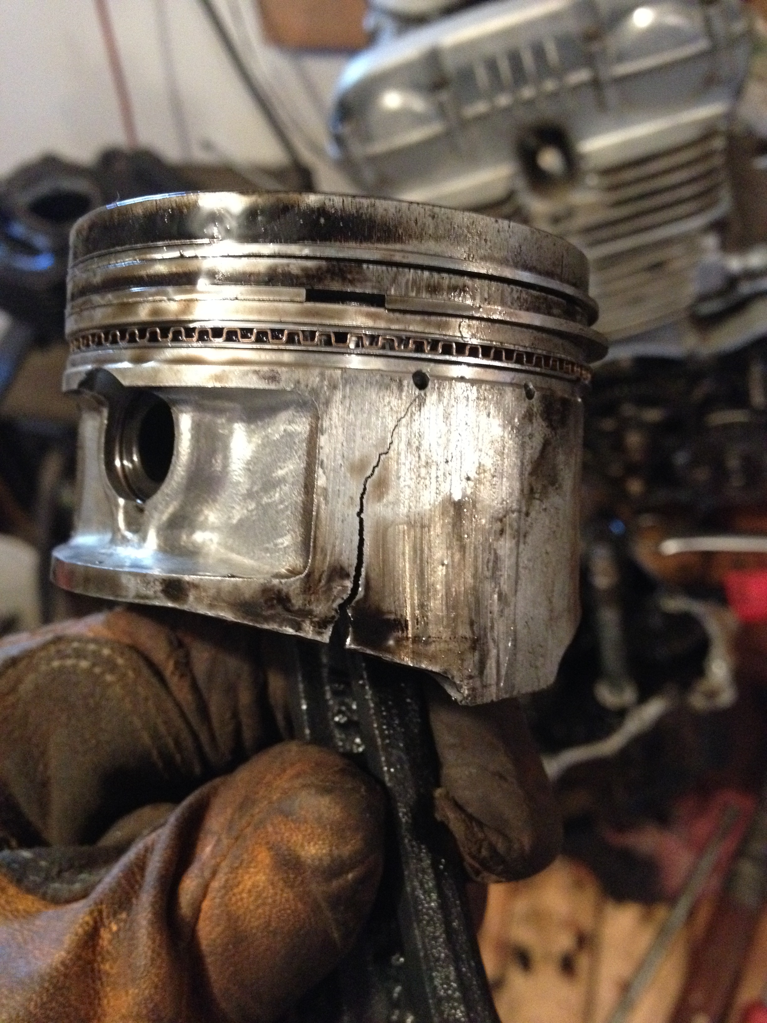

    So a while ago I bought a running 200x with a 185s motor along with a bunch of extra parts. One of the things that I got with it was the original 200x engine that was seized up. Well a buddy of mine and I finally tore into it this weekend to see what the damage was, and it doesn't look good. It looks like what happened was it threw a con-rod bearing and busted out the bottom of the con-rod (see pictures below). On these motors the bottom of the con-rod is wider than the gap in the crank weights except for the journal that it runs through as the crank rotates over it. Once the con-rod went on this engine the crank came back around and wedged the con-rod between the counter weights on crank. It took a punch and a big to get it back out. By the looks of things this wasn't a gentle stop, when that con-rod got wedged in the motor came to a sudden stop cracking the cylinder skirt in 4 places, the piston in 3 places, it had enough force to crack the bottom of the hole where the wrist pin goes into the piston. It also cracked off a big chunk of something in the right side case behind the flywheel, and it even managed to shear the flywheel key clean.
    So I've got a few questions for you helpful folks, what should i do with this engine? Is it worth saving? my initial thought is no, but I wanted a few other people to weigh it. I haven't started looking for parts and prices yet but I was also wondering weren't there other Honda engines that used some interchangeable parts such as the CL series? (Or was it a different series?) Would these engine parts interchange with mine? And do you think they might be a little cheaper? Give me your thoughts please.
