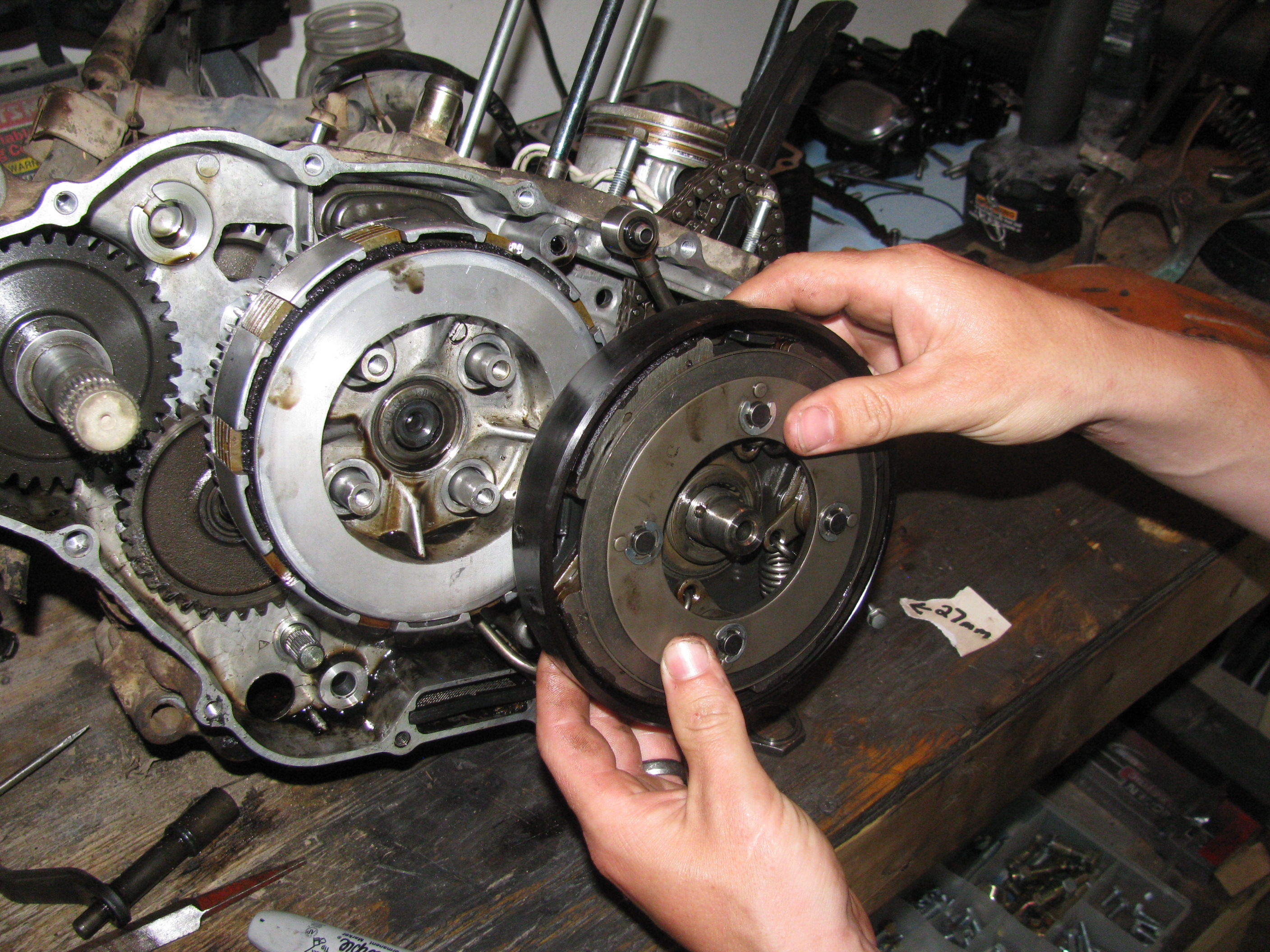

    Okay did a test run on my parts motor; 86' 250ES pretty much the same motor as 250SX. Step by step plus some pictures hope this will help someone!!!
    Step 1: Take Valve cover and cam shaft off/out 8MM and 10MM wrench/ratchet. Pretty simple and self explanatory, (valve cover on right you don't need to remove head but makes the process easier).
    Step 2: Remove kick start and clutch cover, 8MM wrench/ratchet
    Step 3: Remove oil line, it just pulls out, be careful not to bend excessively.
    Step 4: Take centrifugal clutch nut off using 27MM socket (LEFT HAND THRED). And simply pull clutch off.
ID:	194371Click image for larger version.
ID:	194372Click image for larger version.
    Step 5: Remove 4 bolts, plate and springs off manual clutch. Take manual clutch nut off 27mm (RIGHT HAND THREAD), and slide manual clutch off.
ID:	194374Click image for larger version.
ID:	194375Click image for larger version.
    Step 6: Take two bolts off that are holding oil line on 10MM wrench and remove oil line.
    Step 7: Take three bolts out of oil put 8mm wrench, and simply slide oil pump and gears behind off at one time.
ID:	194378Click image for larger version.
    Step 8: Now your chain is exposed, take old one off put new one on feed up through the cylinder, head, and onto your upper cam gear. As far as I know reverse the process to put back together. Look at manual for torque specs. please look back at my pictures and ask any questions. Hope it helps!

    You're my freakin' hero.
    Thanks so much for posting the carnage.
    I'm next, but thanks to you, I have something to dream about.
    Seriously, I reeeeeally appreciate that you took time to take pix.\Not easy to do in the midst of flying tools.
    All ya gotta worry about now is trying NOT to get more.
    You're gonna love it

    Not a prob if I had found a thread like this I never would have spent 4 hours carefully figuring it out haha. glad I could help. I am goin to be looking back at my pix as I do the actual chain in the 250sx when the chain comes in I HATE MAIL!!!
