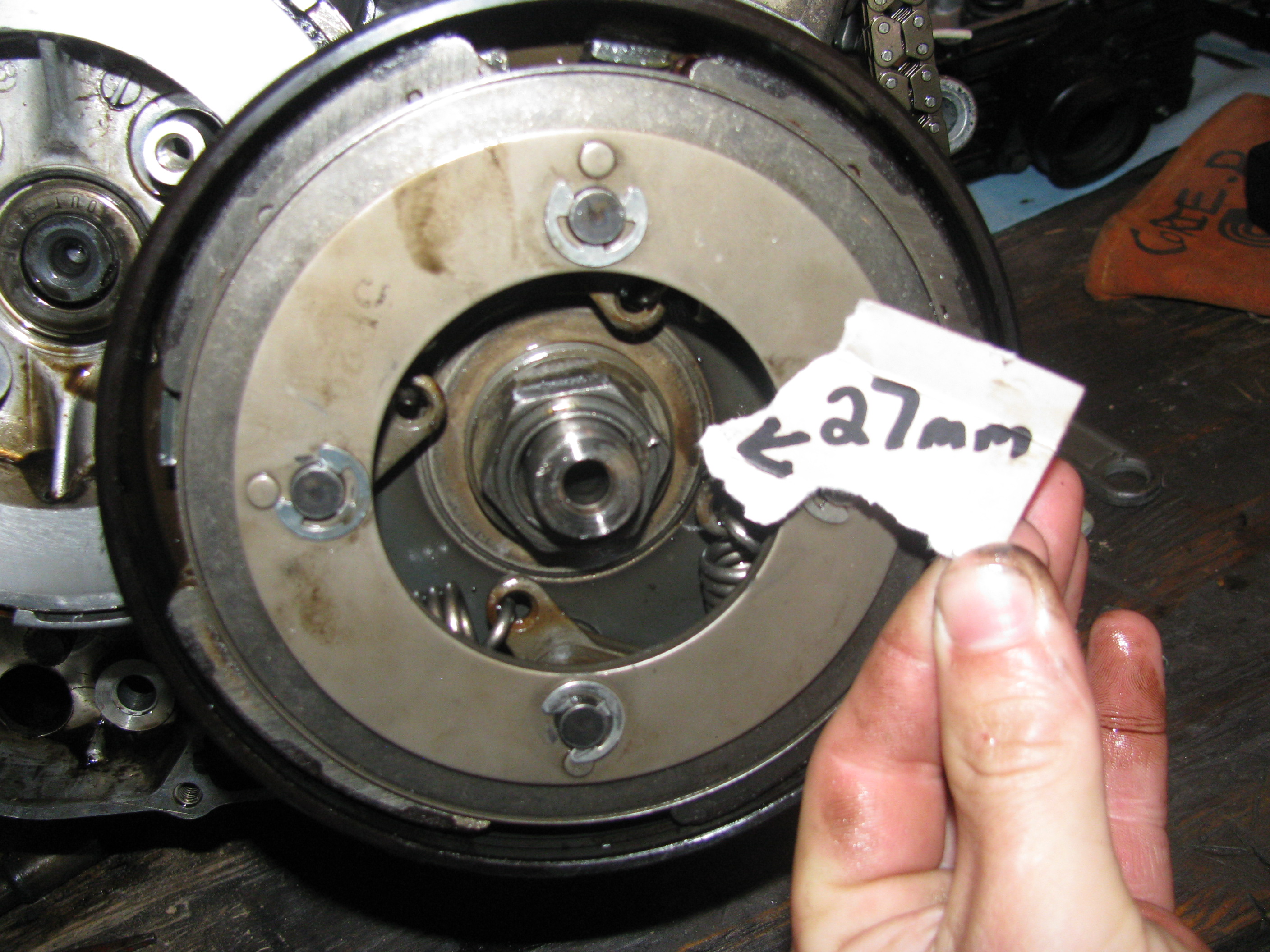

    Step 4: Take centrifugal clutch nut off using 27MM socket (LEFT HAND THRED). And simply pull clutch off.
ID:	194371Click image for larger version.
ID:	194372Click image for larger version.

    You're my freakin' hero.
    Thanks so much for posting the carnage.
    I'm next, but thanks to you, I have something to dream about.
    Seriously, I reeeeeally appreciate that you took time to take pix.\Not easy to do in the midst of flying tools.
    All ya gotta worry about now is trying NOT to get more.
    You're gonna love it
