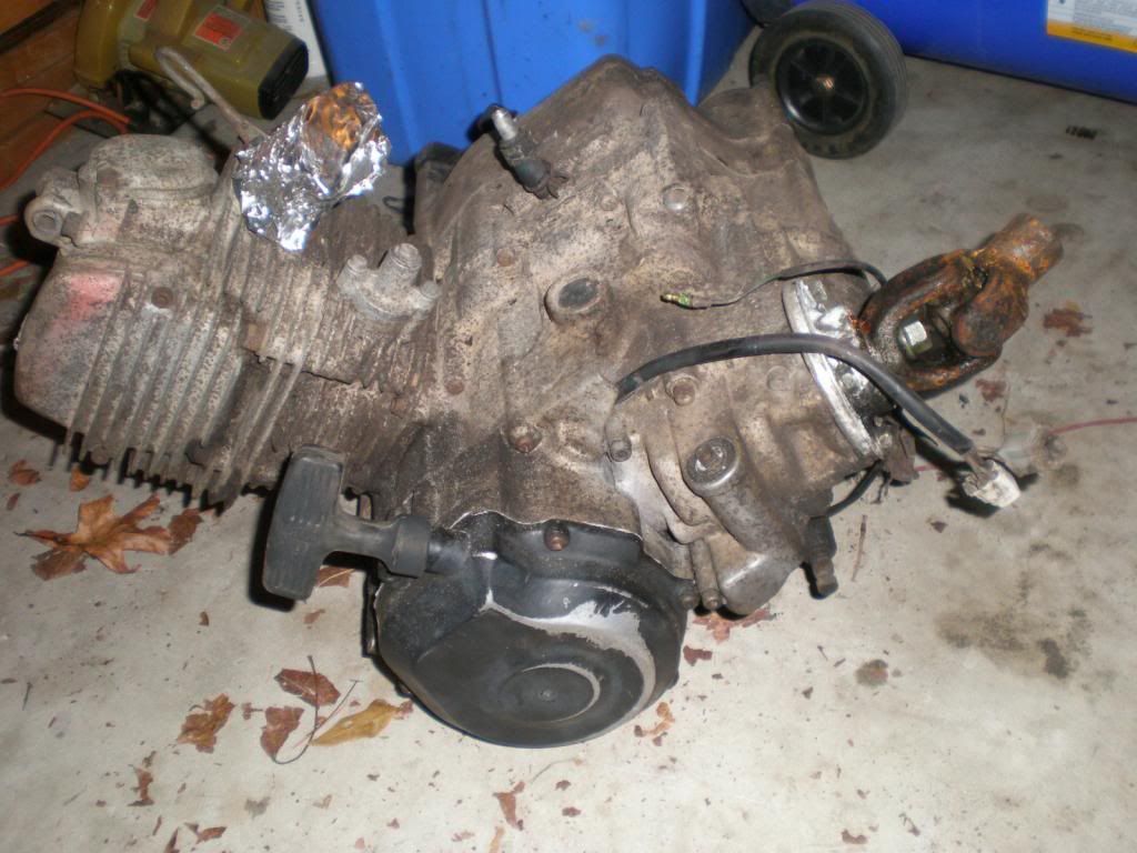

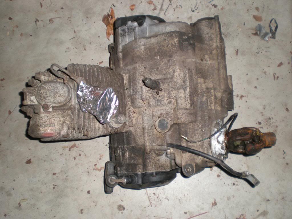

    These are the posts that got my attention, so I started doing some digging. Here is what I found.
    These pics are from a Yamaha YFM225 Moto-4 engine-
    These are from a 92 Yamaha Timberwolf-
    This is a Yamaha 225DX engine-
    I think it's pretty clear that not all of the Moto-4 engines will work.

    Moto 4 225,and 250 will not work. They're the 1st pic. Twolf? I have never done one,but they are similar. That would be the easiest to start with.And it would be a decade newer stuff too.

    The 225dx has the drive shaft on the left side but the 225 four moto has the drive shaft in the center thats why the four moto is a duel shock. I do have a 225 four moto motor if anyone can figure out how to convert it to a left side drive shaft.
