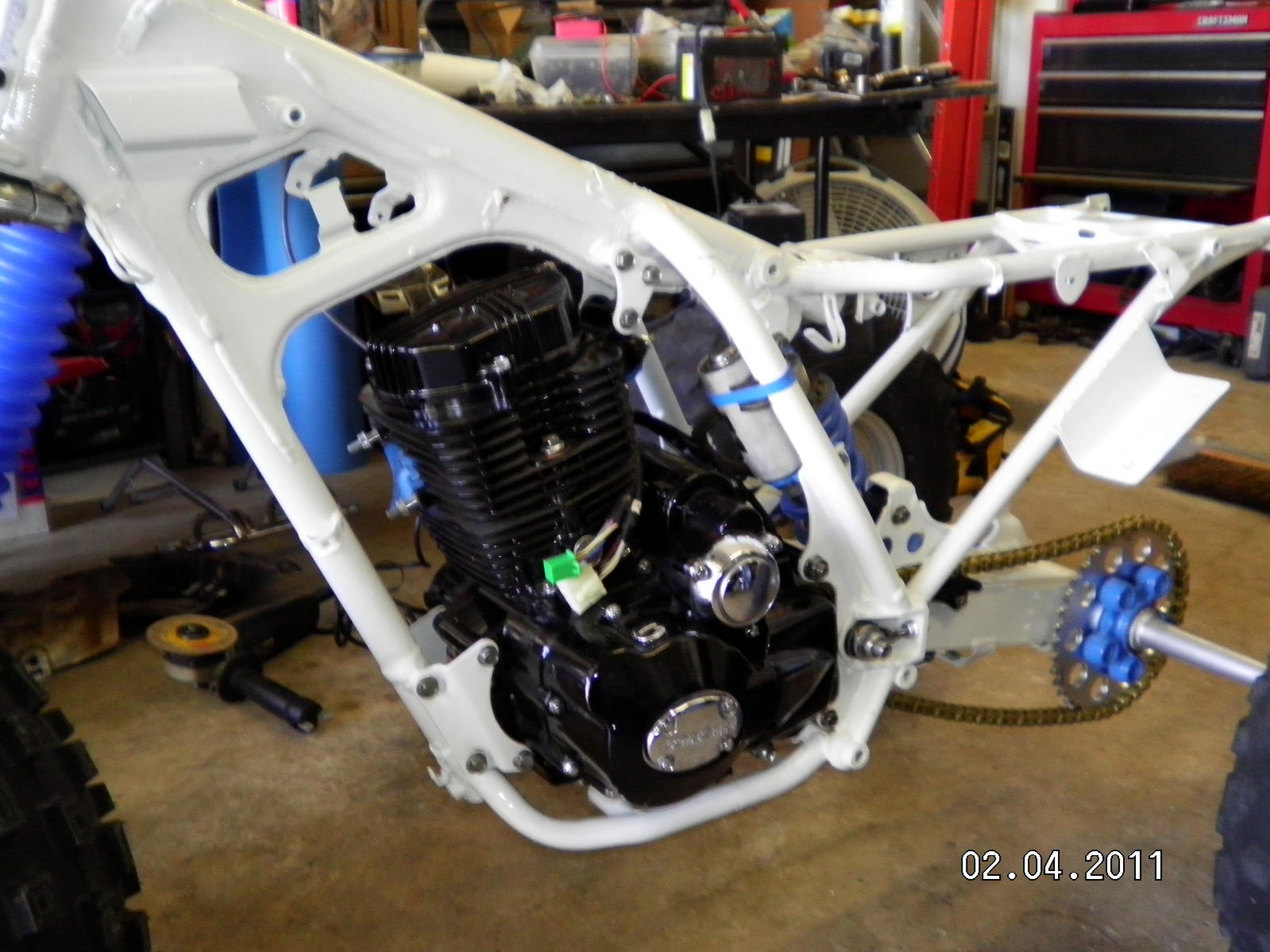

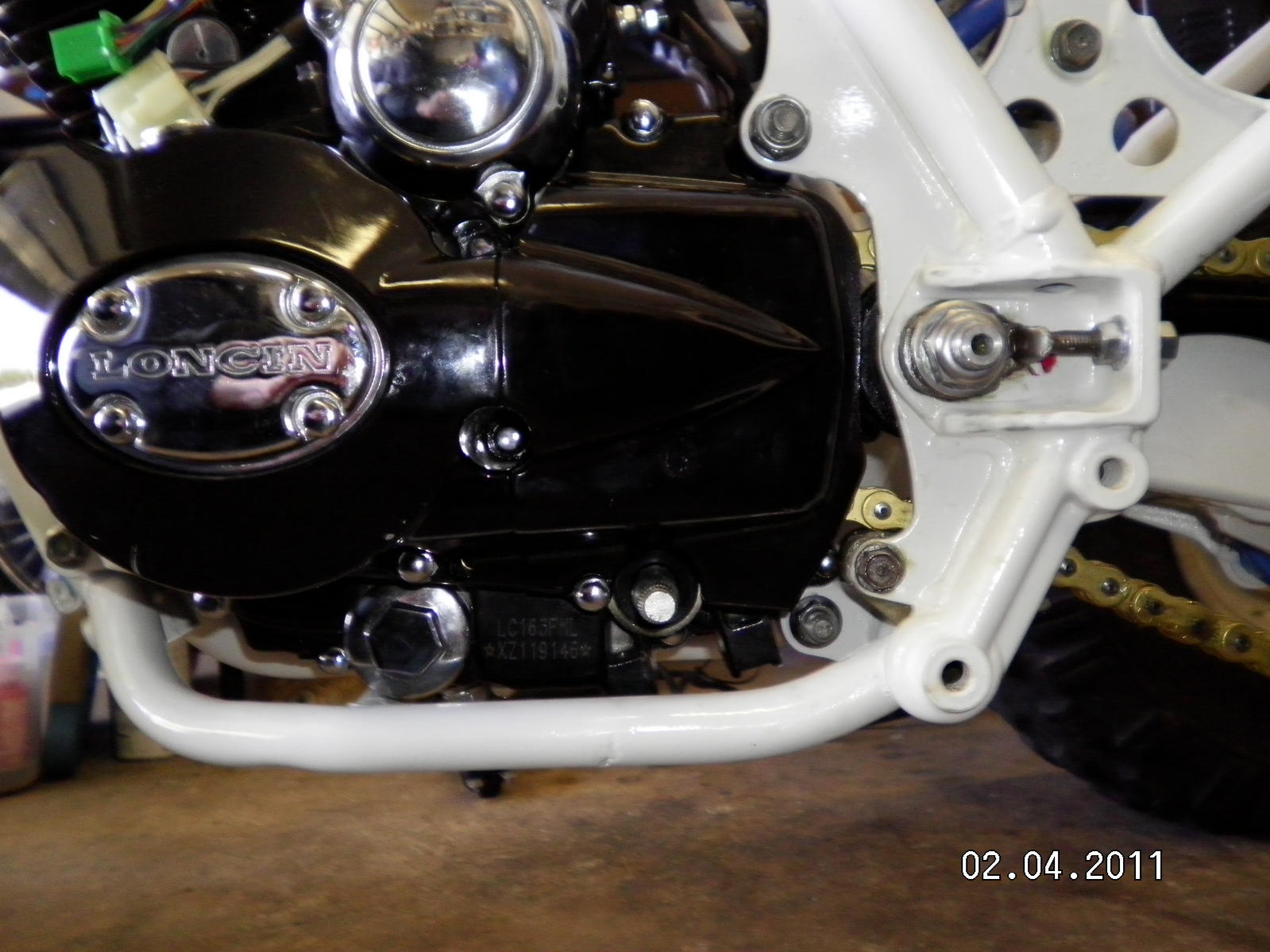

    Is that really 250cc? I have the 200cc OHV version in one of my 84x's. The one in your link looks taller - bigger space between cylinder and head. I could just be seeing things, though. Call Hooper and ask them. It would be worth checking the location of the upper mount and height of the engine.
    You lose the brake pedal mount. I used a 350x pedal on mine.
    I had to trim part of the sprocket cover and make room on one of the crossmembers to clear the drain plug.
    I welded on piece of sheet metal and some nuts to hold a 400ex battery tray.
    I made my own wiring harness because my X did not come with one. It's pretty cool - the battery powers the lights and starter but the engine will run without it if you can push start it.
    I love this engine - I paid $180 for a complete dirt bike donor.
    Some pics:

    I copied this guys idea:
    http://www.3wheelerworld.com/showthr...90-lifan-200cc
