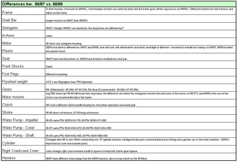

    Don't go by body panels as defining the year of the bike. Guys changed these things around like underwear. The 86/87 bikes had the same swingarm and rear engine mount as the 86 ATC. The 88/89 bikes used a aluminum swingarm and used a solid rear engine mount that was welded to the frame. also the 86/87 bikes had footpegs that bolted to the frame using two bolts similar to the atc's. The 88-89 bikes had a round tube with a tab welded to it and used one bolt. These are just a few. there are actually many differences but these are the ones that stand out.

    Other differences: (I made this for atv riders...)
