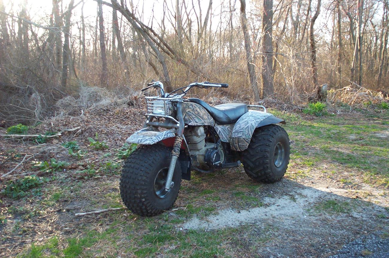

    I used the moose camo kits (that 3wheelsinpa has a link to) a few years back on my 185. With a little prep it came out well and so far held up over the 6-7 years i had it on. It did take some time to plan and put on, and I ended up with extra. Wish I thought of the glue trick as it tended to peel over the years on the high wear area. but i was able to repair it with the extra i had.
    the kit was way better than the previous owners paint job - which you can still see on the forks.

    Nice job from what I can see. So the kit consisting of 6” W by 12’ L rolls gave you enough to cover the trike???? not bad for the price.

    Nice pic - Is that Mossy oak camo?
